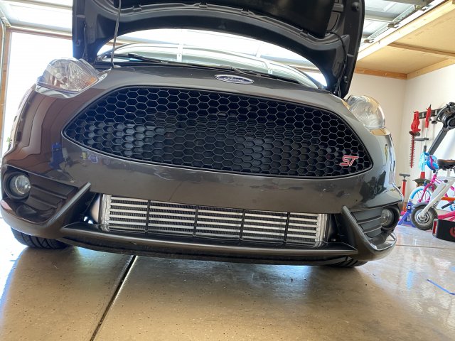

I’m running the V3 with a larger turbo with no issues. I live up north though. As for color, I went black but both units look amazing in person! Do you want flashy or to blend in? Here’s a pic of my setup .

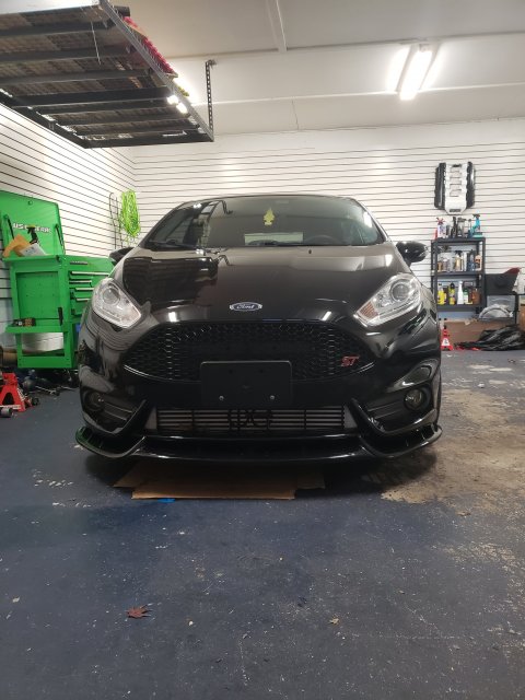

Installed whoosh v3. It’s a tight fit but didn’t require any trimming. Took around 90 min start to finish to install the FMIC and a traction bar.
