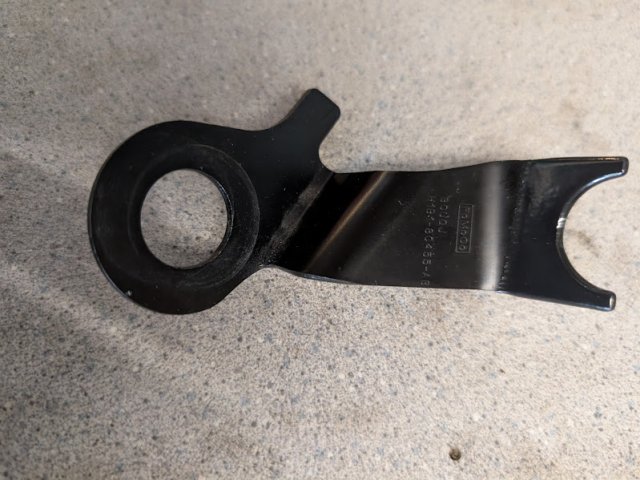

Wondering if this bit is important...
#6990
29
18
when reassembling the car after the timing belt job I just did, this was on the engine mount, but for the life of me I can't figure out how to orient it to put it back in. i've left it out for now. does anyone have a picture of this in the car?

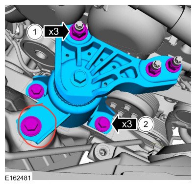

This part is bolted on top of the passenger motor mount (the bolt that is most to the left if looking at the engine from the front) and helps support the underside of the coolant tank.
Hope this helps :)
