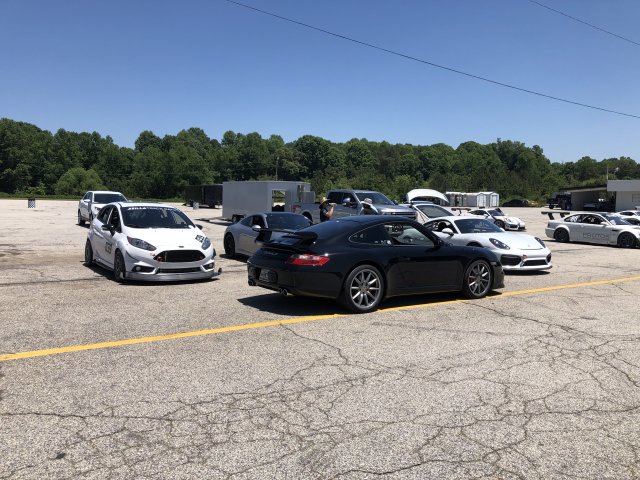

What's up with that car with the Protos logo on the side?
More info? :eek:
It’s my buddy’s who’s a racing driver. I know nothing about it though. Not sure if he wants me to mention him online either. Sorry. The two of them are super fast though. 😉 Most of the cars at our club events are ridiculous. I probably have the only car under $100k except maybe a couple of old spec-Miatas and another buddy’s GTI. It’s kinda funny. My Fiesta holds its own, that’s for sure.
