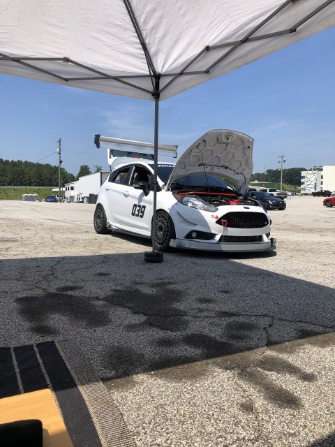

Few more hours on track today. I’m getting the P061A code again and my airbag light was triggered my first two sessions. Car still ran strong and I had A LOT of solo time on track. Enough to completely wear out my 215 RT660s. They held up extremely well during 25 minute sessions all day until the rear tires were cooked.. It’s time for a new set of 235s! The 215 RT660 has more grip than my 235 RT615K+ but I still love the RT615K+ durability and consistency. The RT660 grip is real though lol. Can’t wait to see how much more the wider version has.
My only pics from today and they are shit lol
