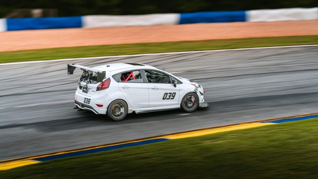

It’s broken so I blew its doors off. He has 295 square so it’s kinda hard to stay anywhere near it when it runs. It was pretty humid this weekend so my car struggled to make power. I got a little frustrated because I could only manage consistent 41s. Thats fast but there is more in it. My clutch still needs to be bled correctly so I need to find someone who can do it. That cost me time along with beat RT660s. Excuses aside, I had an absolute ball. There’s nothing better than open track at Road Atlanta. So much time!!!
