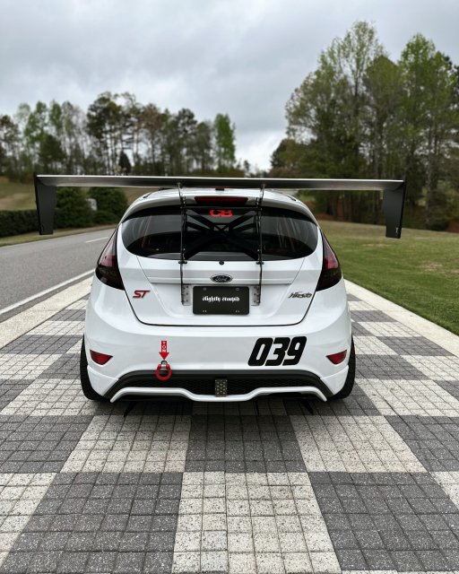

Shook down the car today. The Wavetrac does what’s advertised. Totally hooks up both wheels predictably. I was able to put an hour or so on it today at Barber. The real test will be Road Atlanta in a few weeks but it definitely hooks up better than my old MFactory helical. If you’re gonna track and don’t want a clutch type diff go with the Wavetrac. I ran my street wheels and Federal 595RSR today since they spin a lot easier than my track wheels. I just need to bleed the clutch one more time and change brake pads then it’s good to go. Hopefully for a long time..
