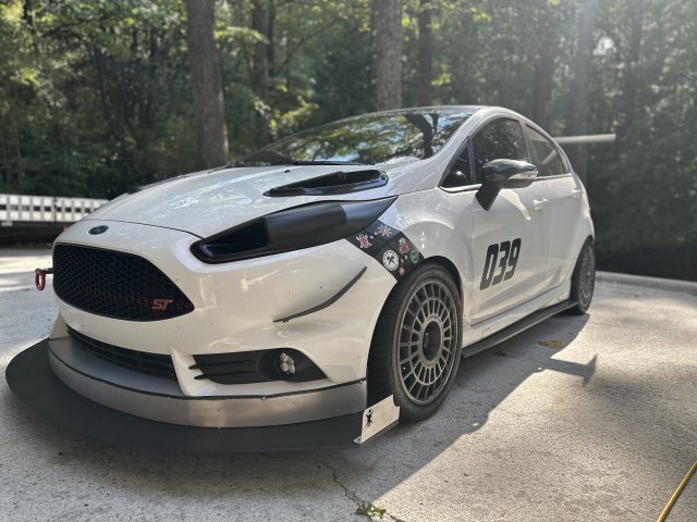

They are functional on the WRC Rally 1-4 class rides, but then those cars do have specific front clip ducting to fully take advantage of those vents, by design. [wink]
Beneath the hood of rally cars is totally different than an OEM Fiesta ST. Peer down their vents and you won’t see fuse boxes, ABS pumps and other stuff blocking airflow. I was duped like everyone else who cut holes in their hoods. Maybe if I removed ABS and AC then relocated the fuse box and coolant tank they’d work a bit better but in my opinion they’re useless.
@Jkingtana I installed the vents to evacuate air from being packed up under the hood when driving over 100mph. I’ve seen zero gains from these specific vents in regards to cooling or aero performance. If your tuner is recommending them, they’re wrong. You have another issue such as air in the system or the Mountune radiator itself is inadequate for your requirements. If you’ve proven air isn’t in the system, sell it and purchase a Mishimoto or CSF. That would be my advice. All of these cars suffer from overheating with the stock system. Ford recalled them and added a cooler thermostat but a proven aftermarket radiator is the solution. I’ve had absolutely zero problems since adding the Mishimoto thermostat and radiator years ago.

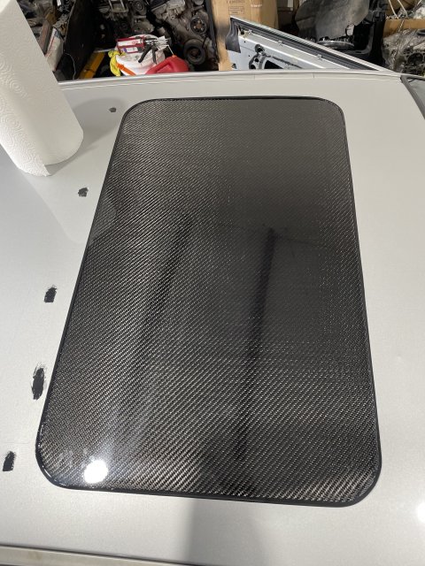

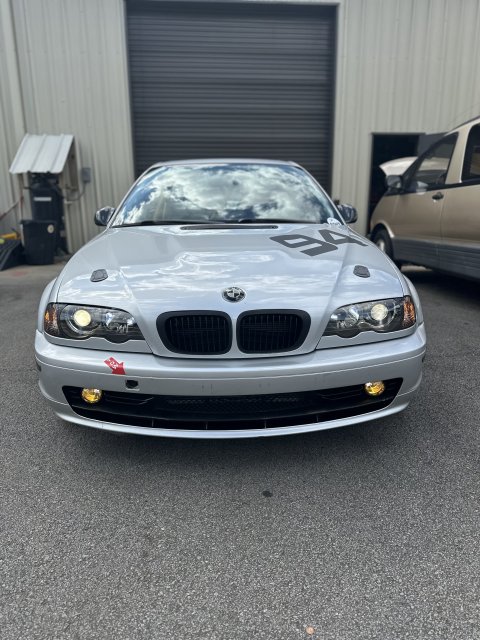

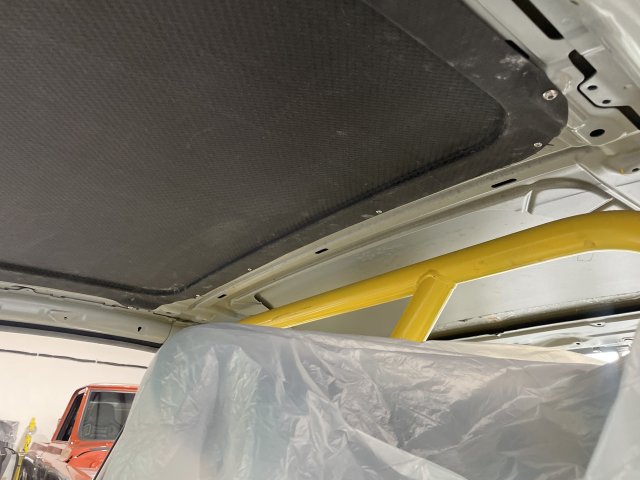

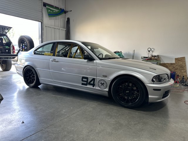

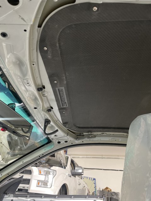

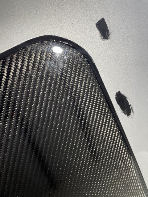

Checkout the sweet AJ Hartman sunroof delete. It fit the e46 perfectly. Never mind the black spots. Dipshit previous owner half assed the installation of the fiberglass delete with long self tapping screws. We used rivnuts and 3M panel bond adhesive. I’m gonna wrap the roof after I get the dents removed so it’ll look somewhat better. The car finally runs perfect after replacing the entire cooling system, ccv system, secondary air pump delete and new headers. The Fiesta is still way faster around the track but that’s not the point of this car. I’m finally about to have a chance to race door to door and be competitive. IMG_4914.jpeg IMG_4915.jpeg 74838901932__AE57BA10-D46C-4E6E-8214-D4DC81CE9D03.jpeg 74838903885__57BB4AE5-78F3-4DED-9DAF-4CB3DCAB4486.jpeg IMG_6108.jpeg IMG_5937.jpeg
