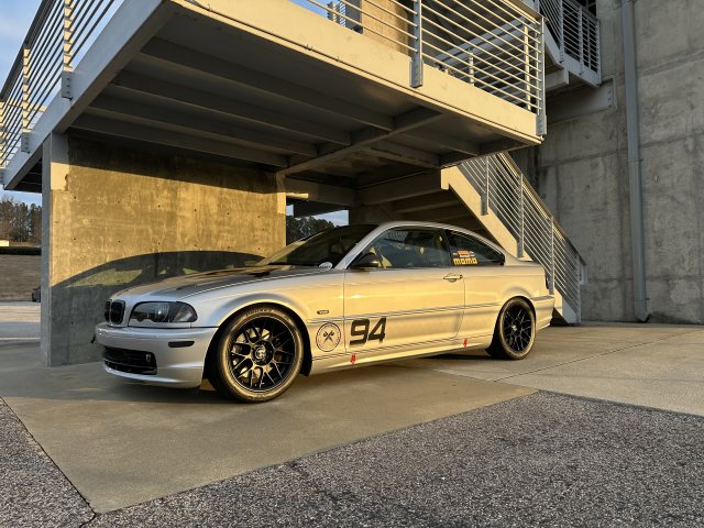

Thread Starter #1,929
I've seen those parts on some local Mustangs on NASA and all the owners I spoke with were happy with fitment and quality. And they seem to make things with weight in mind as well. I'm sure they could whip something up for you
I have a sunroof delete from him on my E46 and it fits perfectly, even inside where the mounting locations are. Next time I’m up at VIR I’ll mention it. I’m sure it’ll be $4k though lol

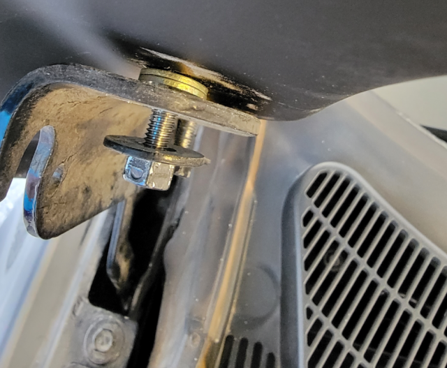

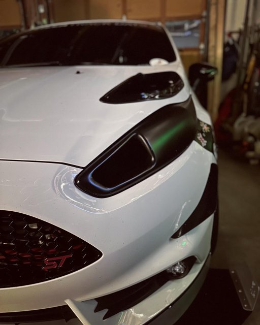

I'd say it's worth it if you are running out of other weight-loss ideas. Swap was easy and the CF hood is much lighter. I don't have a way to measure the hood weights but it's about 10 lbs lighter per the Fiesta ST Weights Thread. I added a couple of washer for the rear to line up, but otherwise, the fitment is good. Rubber piece you see in front is due to the bumper cover bulge from the aftermarket IC install and was there before the hood swap.

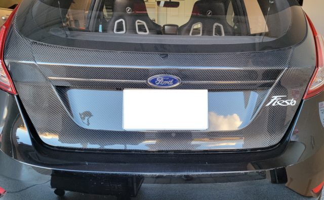

Their CF hatch, on the other hand, doesn't fit was well. It's hard to tell in this picture, but the gap on the left side is about double the right side. But I guess making a hatch is more complicated than a hood.

That's beautiful and very tempting! Thanks for sharing. i really appreciate it! A buddy is about to install a hatch on his. I look forward to seeing it in person.

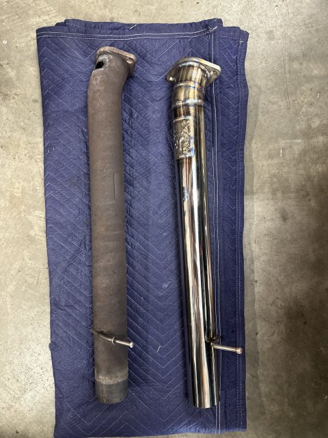

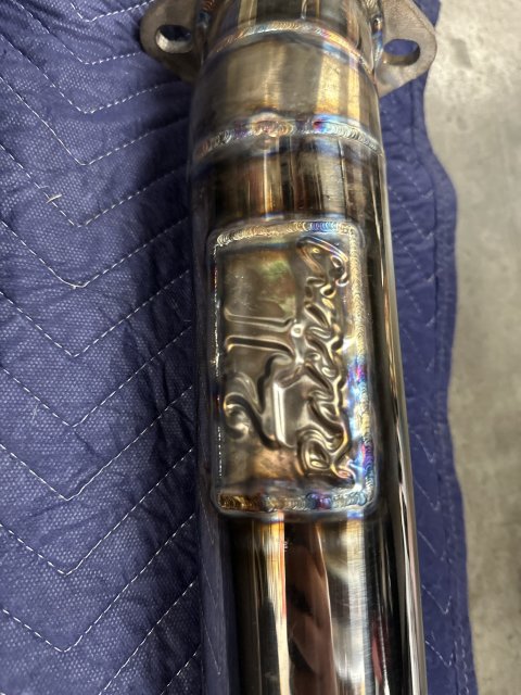

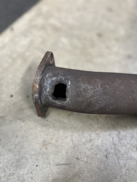

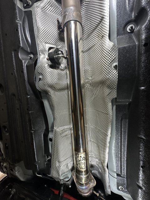

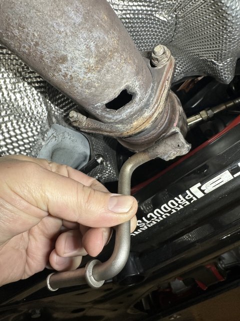

Checkout what Dakota whipped up at 2J Racing this morning. Those guys are so awesome. Slammed with work but put it all aside and built me a delete so I can take the car to Road Atlanta tomorrow. I wish they had more support from the Fiesta community. You guys should see the Ti exhausts with carbon tips they make for the Corollas. It’s absolute art!

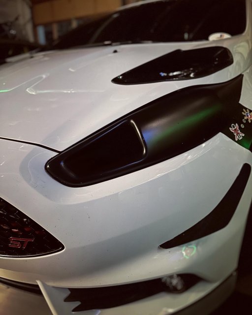

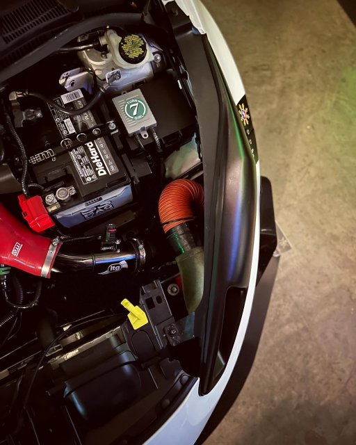

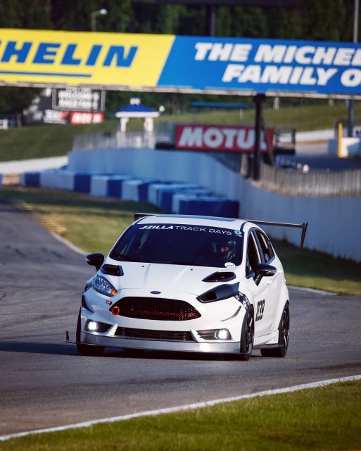

I spent four days at Road Atlanta this week. Three with the Fiesta. The car started misfiring under WOT during the last session after I added 6gal of e30. The gas is likely ok since I ran 12gal of the same earlier without issue. Hoping a spark plug loosened up or maybe a coil is going bad from excessive heat. I’ll tear into it when I have time. No codes so hopefully it’s minor.

Oooof. Just got an opportunity to buy a dream car I’ve been familiar with for nearly a decade. I don’t think this one can be passed up. Never say never I guess. There’s a local who’s wanted my Fiesta for several years. It might be time. By the way, the stutter was just old plugs and lots of track time last week. Easy fix per usual.
