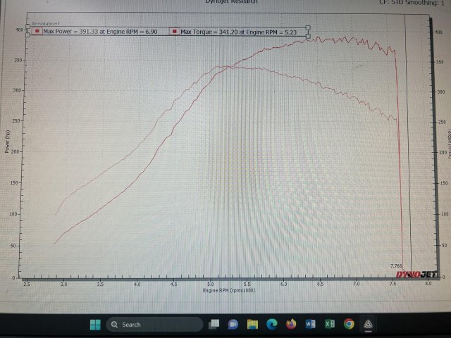

I hit 270 whp consistently on a few logs according to Vdyno, on 91. It’s definitely possible
I think he was just being conservative with his numbers as to not raise expectations to high. Probably using a average with boost weather and dead heat of summer numbers. But as far as what he is saying no matter the turbo x37, whoosh, s280 91 octane WHP numbers are approximately the same.

Sorry for the late response here as I'm not to active here on the forum. So, with the x37 there is really zero point to doing the 30% injectors without a hpfp. So, to kind of explain on larger like the gtx2860 where we can carry power all the way to redline at 7500rpm we tend to hit the limit on the stock injectors on pump 93 at around 25psi of boost. We can move the end of injection as far as possible to around 20 degrees btc and really widen the injection window but we will still be maxed out on injector around 6500 rpm as the window we can inject fuel Time wise shrinks the further we spin the engine out. These larger turbos can benefit to larger injectors due to this reason as well as there not making much boost before 4000rpm, so we aren't making the hpfp struggle as much at those lower rpms. Now on the flip side of the coin you have smaller turbos like the hybrids which make boost almost identical to a stock turbo. These play hell on the stock hpfp as we demand a lot of fuel where the pump physically cannot make pressure that's why we see pressure drop more so on these setups. The hybrids also aren't really pushing the airflow at high rpm so there is typically plenty of injection window left up there to max the turbo out being the hybrid is going to make peak hp around 6000rpm. There isn't a ton of reason to rev a hybrid to 7500 because of that. That's why you don't see tuners letting customers rev that high with them. There's no point it's done making power way before 7500 lol on a hybrid setup you would benefit more from a hpfp upgrade with stock injectors more than you would the 30% injectors alone. As far as them being safe yes if your tuner is competent then it doesn't matter the injectors alone will not cause any failures. I would personally recommend doing the Nostrum Hpfp first over the 30% injectors as you will gain much more throughout the powerband the turbo is capable of. I also want to mention I have been working with Nostrum on their pump data and we have fixed issues with the tuning data and completely tapped out the 30% injectors. The nostrum Hpfp Is capable of 400whp on Full e85 with the 30% injectors Granted this was done on my personal car but reaching nostrums rating of 375whp on e85 is not an issue. Nostrum is working on some larger then 30% injectors now as well after we maxed out the 30s so Stay tuned!! Dyno sheet attached!

This explanation makes a lot of sense - so if understand correctly, hybrids that make power down low where the fuel pump is running slow, but the injection window is long are pressure limited even on stock injectors, but bigger turbos that don’t make power till higher RPM are more limited by the flow volume of the injectors up high, where the HPFP is already running at higher speeds.

Yes correct! basically at around 7000rpm our injection window is about 7 milliseconds at lower rpm our window is wider as the engine is physically moving the piston slower.

I understand there is zero point to do 30% injectors with stock pump on 91 or 93 octane. As far as I was informed ethanol blends are where I could make the extra power. Are you saying that I would make zero extra power with my x37 30% injectors stock pump and a e40 blend?

you could make alittle more power but your talking minimal gains. Its not that there are zero gains its that the cost vs gain is small its not quite as much as some make it out to be. The main limiting factor is still the hpfp witch is going to be tapped out within the powerband your turbo is capable of. Like i mentioned the injector issue is mostly saw from 6k-7500 rpm where the injection window is tight. Where that turbo is capable of actually making power your more hpfp limited then anything. Upgrading to a nostrum or xdi pump, running the rail pressure higher as well rescaling the injector flow rate table for that higher pressure is going to gain you more then just doing injectors. Basically the injectors flow more at higher pressure. From my testing a set of 30% injectors flow roughly 8% more for every 400psi rail pressure. This trend will also work on stock injectors. Ive yet to test with the stock injectors but I will be swapping the hpfp our other fiesta to the Wor Fab car witch has similar modifications to my Og car to see how much further the stock injectors can be pushed with just a hpfp upgrade and higher rail pressure 🤘
