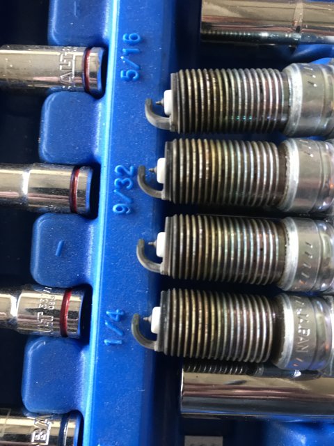

-1.25/+3.25 corrections cylinder 4. Worn plugs? Something else?

I'm trying to run without the engine cover. I found a place on the corner of the ST engine cover that it was tapping against the 2jr intake on deceleration (it was a little shiny spot - about 0.5" between the engine cover and the intake pipe). I'm wonder if that tapping on deceleration was maybe enough to trigger a single knock when letting off the gas. I'm still running cobb stage 0, a new set of plugs from whoosh should be coming in today, then I'll flash back to dizzy and see wassup.

I grabbed another data log. Is it possible I get the negative corrections because I am torquing through from ~3000 rpm instead of downshifting? This is easily the smallest-engined turbo car I've had so maybe I just need to break the torque habit and downshift more. There are positive corrections as it advances timing, then a knock (3300rpm @ 12.9psi of boost) and boom - negative corrections. I generally get one knock/negative correction every time I drive the car. The more I read the more it sounds like I am well within "safe" with that low number of knocks, but I'd like to hear a little positive confirmation before I just call it "ok".

I think that my takeaway is that I might be way too knock sensitive, and that I don't necessarily need the 1-step colder plugs.
On the knock sensitivity, I'm coming from some old school turbo tuning where you generally knew you had knock when you holed a piston. The FiST does a pretty good job of scaling things down. A few negative corrections are fine, as long as the OAR doesn't drop, right?
In my old GN and Omni GLHS, any knock you could detect was bad, but the FiST seems to auto-correct really well.
Since most of my knock seems to be at part throttle/low RPM I guess maybe I just have to get used to downshifting more. I'll make the adjustment and see if it curbs some of the knock.
