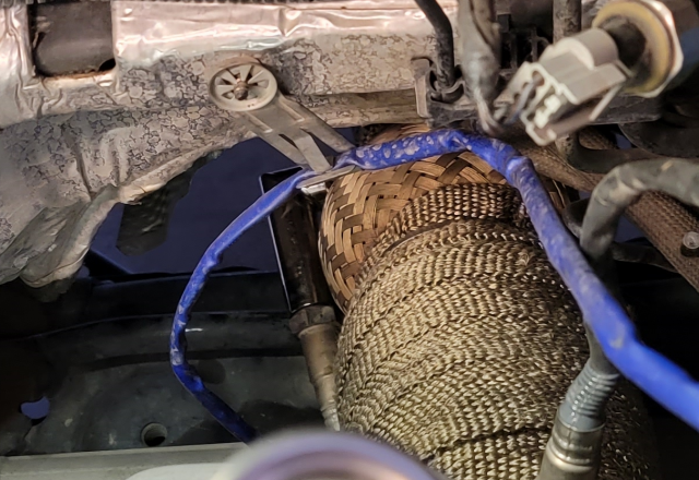

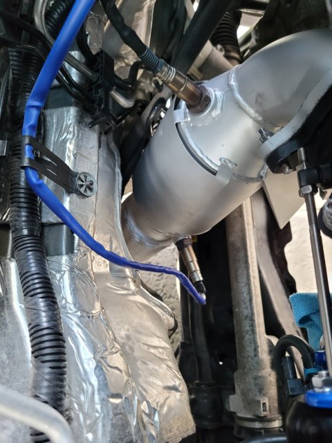

Those with aftermarket downpipes. How did you secure your O2 sensor wires after removing the dp heatshield?

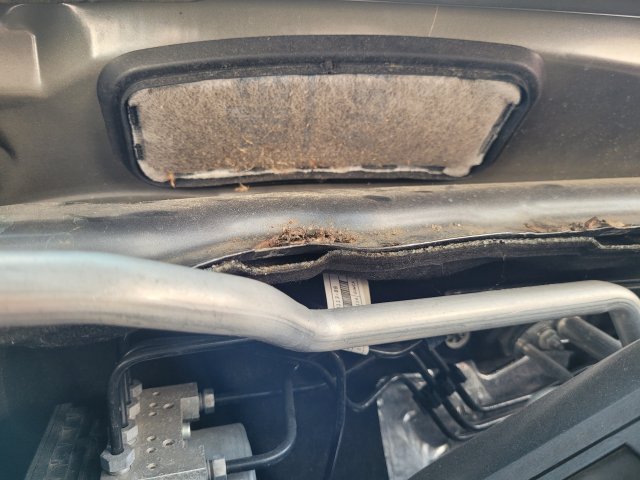

Wondering if this filter should be changed and can it be done from under the hood?
Just going to vacuum it for now and put it on the bucket list
4,223
2,761
LoL that's not a filter. That's just the normal screen to your blower motor.
Unless you had a furball cat living in that space, I don't know how it'd do that. 😂
https://www.fiestastforum.com/threads/how-to-keep-crud-out-of-the-reservoir.30410/
Make sure the clips for that tray, also clip the sound deadening material there.

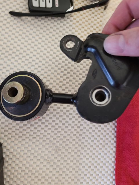

For those that did a vibra technics rmm,
How did you get the bracket to fit on the rmm?
Press in vice?
The bracket is like an octogon...just small enough not to go on the rmm. It slides onto the whoosh just fine. Gonna stick with the whoosh for now and focus on finishing the turbo install.
Press in vice?
Seems like a lot of people use a vice or a press but instructions state you can just mount it and it will get pushed into place from hand power alone. I had to get a cheater bar and put all my weight into it but it was good enough for me to feel happy about it.
Ill probably throw it in a vice and see if it pops into place and tackle another day.

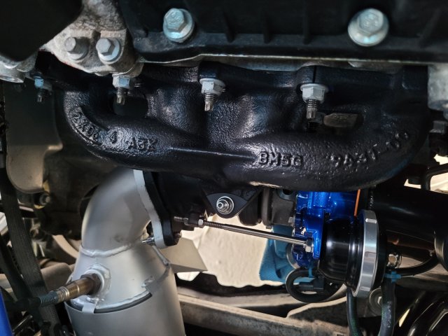

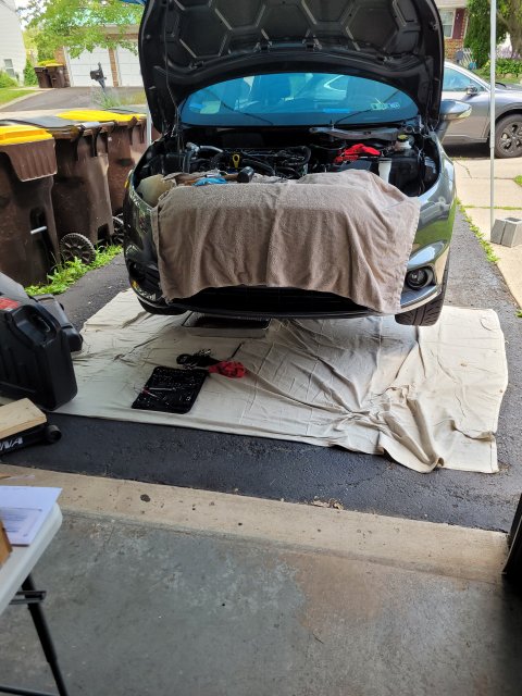

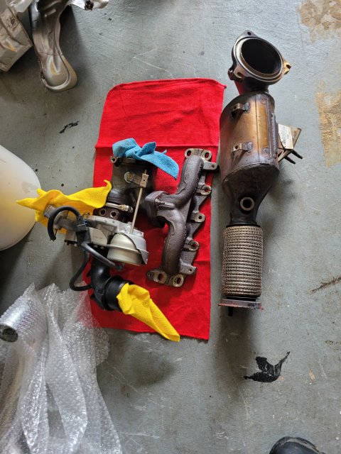

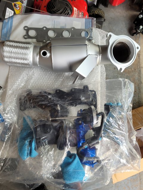

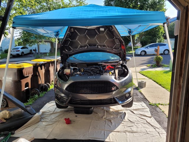

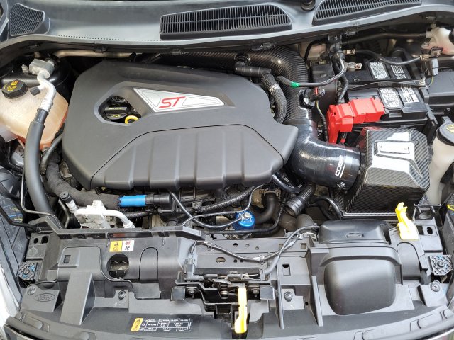

Saturday got the oem turbo/DP/manifold out. Was also able to get the whoosh hybrid in minus some connections. Sunday was nothing but rain so nothing done. Monday (today) finished tightening down the coolant lines, drivers side bracket is a bitch to get back on. Cerakoted heat shield went back in. Whoosh hotside pipe put in. Was tough to get the silicone happy and tightened down correctly. Cobb Redline intake...also a pain in the ass but eventually got it in. Can't use my prop rod latch though which kinda blows. They put some spacer in to deal with it but it didn't help mine. The instructions weren't very good. Got new plugs and 5w30 in it. Tune loaded, got 20ish miles on it now. Whoosh hybrid definitely makes a distinct whistle sound. Honestly could do without it but it's not terrible and sort of neat too.
Glad it's all done but would not want to tackle this job again.

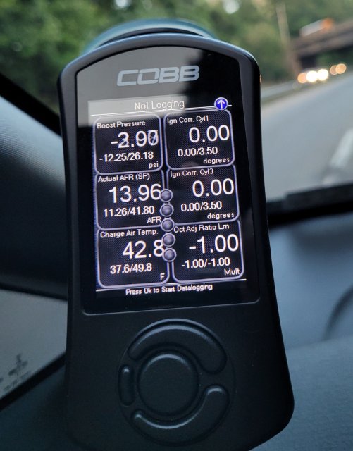

45 miles on it. If the rain clears up will drive a little more then start data logging.

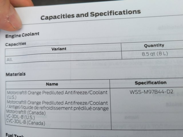

Going to have the coolant flushed out and refilled with the yellow stuff. Lost a little (maybe 1/2 quart) during the install. I have 3 bottles of the Motorcraft prediluted yellow but looking in my manual(s):
Owners Manual says 5.8 qt
Supplemental Manual says 8.5 qts
*edit* forum info found indicates 6.1 quarts
Below are the manuals I got with the car.
Want to tell the shop correct amount.
