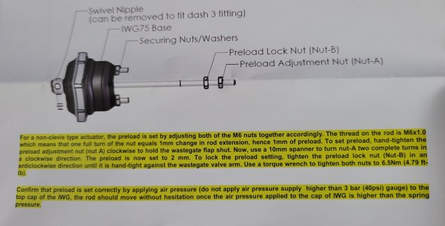

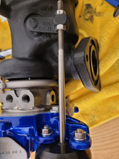

This actually puts it into a perspective I can speak to. Once fully closed the preload nut would then need (4) full turns to reach the recommended (4mm) preload. I think I got this. The visual made more clear. Thank you.
So I emailed my tuner to confirm 4 turns for the whoosh hybrid with the Tune plus wastegate and basically got a smart ass answer explaining that 4mm is a measurement and not turns. I reminded him I watched his youtube video where he literally uses "turns" to describe setting the mm. Of course he didn't reply back to that. Its a shame I wasted 350 on a lifetime tune with that d bag. Oh well Id rather cut my losses than deal with someone like that.

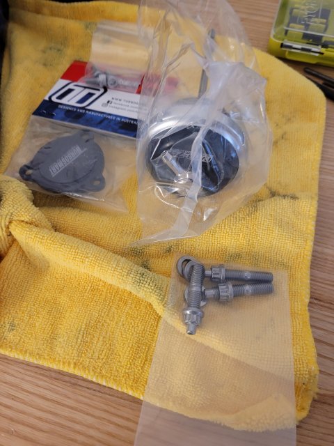

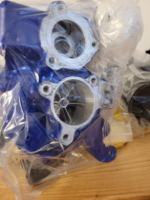

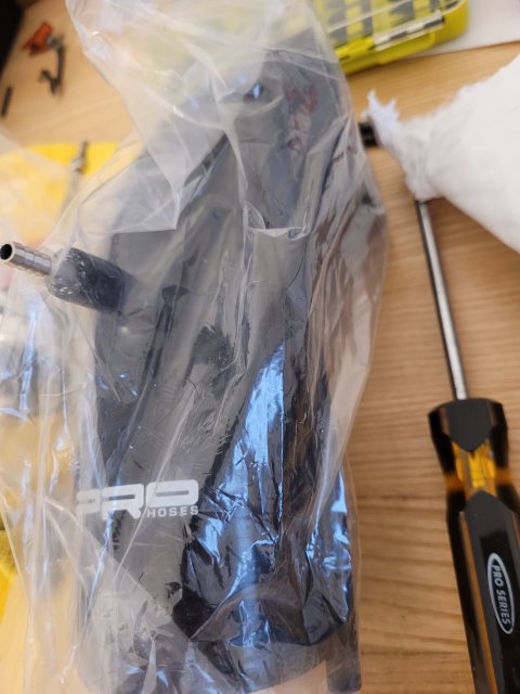

In the process of assembling whoosh hybrid with the waste gate, and fresh boost solenoid and manifold. Earlier I was discussing setting preload and tune + dickhead response. Well right in the instructions...turbosmart spells it out simply as far as number of turns into mm. With the tune plus waste gate he recommends 4mm.
My arp hardware finally showed up, it was the final pieces to this project.
I'm sure I'll be on here verifying the actuator hoses are correct even if I know they are correct.

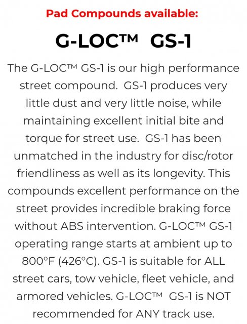

Thinking about this combo for brakes.
They aren't too terrible but the rear rotors are starting to show some rings towards the outside rotor face. Will use the hardware kits from Ford and lube the pins good.

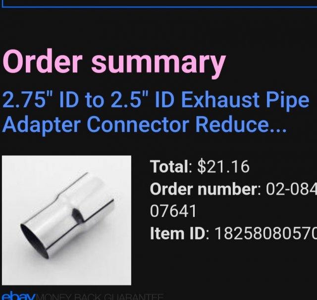

After deciding not to part ways with my Cobb intake, I decided to give 2 options a try.
(In regards to Cobb intake not mating with airtec elbow)
First I bought a whoosh ss elbow as this will work. But before resorting to that I picked up a 2.5" to 2.75" coupler. While meant for exhaust it appears quality 304 ss. It's not beveled like some of the pieces I found but couldn't find one purpose built beveled for what I need but I'm thinking it wouldn't be hard for a machine shop to bevel the edges for clamping silicone elbows to.
This would allow what I would like, the Cobb AND Airtec usage. If I have to resort to the old whoosh elbow, I will use the gasket that came with the airtec.
