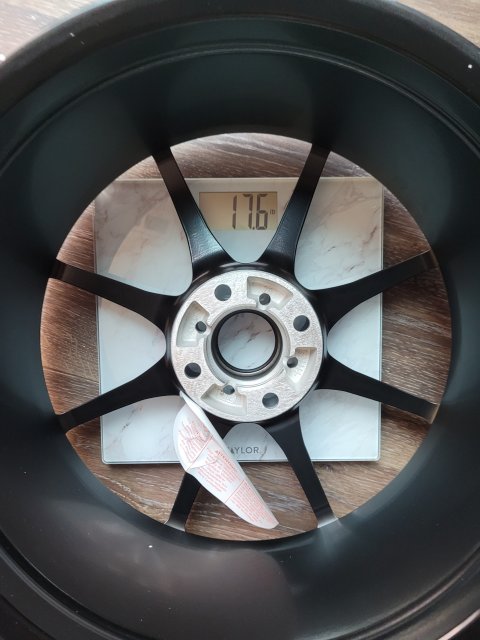

Going to try and get a weight today. I thought the girlfriend had one but it got tossed a while back apparently. Hoping to find a simple scale at Home Depot.
Question to anybody if you are running 200tw tires, do you store those indoors through the winter? I was reading that at low temps the rubber crystallizes and can damage the tire. I store the car during the winter but not in a temp controlled garage. Was thinking Ill need to swap the OEM wheels/tires on when I stick it into storage and keep the OZ/Direzza inside.
ya it actually turns out Dekagrams are 14.8 so there is a 2.6 pound difference. 200TW tires can and do dry out. So ya store indoors in your climate. Leaving them outside would not do you or them any favors. ;)

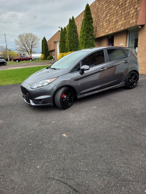

Thread Starter #107
I'm not good at photos but some quick shots. Will have to do it again when the wheels are on

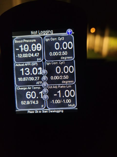

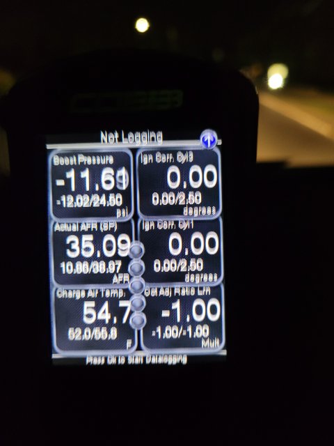

So my E85 tested at 74%. Went with 3.9 gallons and topped of with shell 93. Probably still less than 50 miles with the E30 tune. My afr is hanging around low 13.s dropping into the 12.90s. My oar is beautiful at -1.00. Also boost has been getting lower highs. Used to see 25.8 -26, since putting symposer bov lost a bit and dropped about 1 more psi since the E30. I think the ecu may still be learning, has some of that surge I noticed when I first loaded the 93 tune.
Pictured to the left was last night off throttle.
edit* - its also possible I am letting off a bit as this thing is definitely quicker than on the 93 tune, no matter what the boost numbers say. Pretty sure this will "ask for XX torque" and may not require as much boost to get "xx torque"
Eventually will datalog, maybe this weekend.

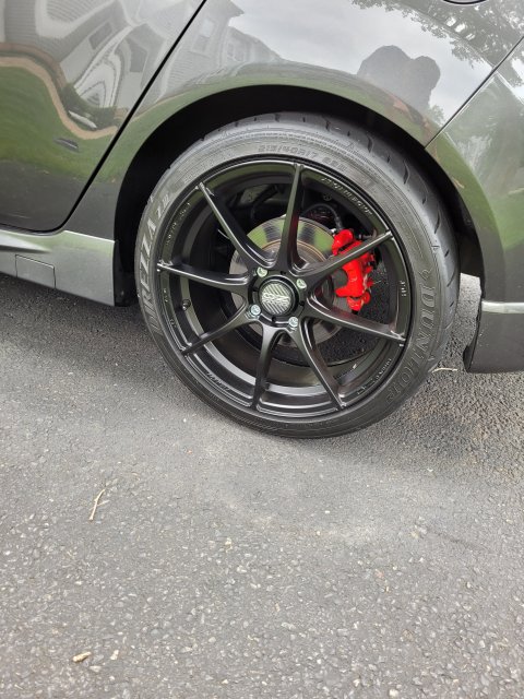

Rather than start a separate thread, going to the 7.5 width wheel and 215 width tire (Direzza) would you start at the factory pressure for street driving? I feel like the pressures would probably need to be different. What do you guys with wider wheels and tires fill the tires to?

Thread Starter #120
I did not know that the OZ wheels came in 7.5 inch wide 17 inch wheel. Is it a new model? Also did you get your tires from Tire Rack? It will take me a month till I get those tires. How long did it take for you to get the tires. Looks good by the way [emoji106]
I am not sure when they came out but I think there were some non english youtube vids from 2016ish maybe? Called Formula HLT which is their flow form tech. Only way I could find to get them was to import from UK/Europe. They come with their own kit of aluminum rings, lugs and supposed to come with a spline key but of course mine wasnt included ha! The process made my wheel/tire foo pretty resilient. Tires lol. Yeah I ordered them back in April and they were delayed for about a month or so. Yes I ordered them from Tire Rack. It delayed things but I am very happy with them so far. Its not a daily so the delay just made em that much sweeter. I must say Tire Rack was able to actually speed things up after I called them and had them change the warehouse they were using to ship them to me.
