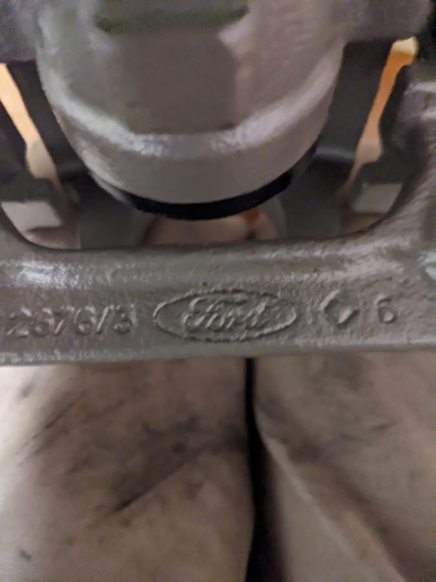

Lmk if the brackets are as expected. I e been trying to source them for a while but no easy way.
They are exactly as expected. colors are different on each side but I plan on having the brackets powdercoated as close to the color red the fronts are powdercoated. More proof that they are not just some knockoff aftermarkets but genuine real deal FoMoCo parts. They are also super clean and rust free. Someone does have a set of brackets and rotors on eBay for $180 though.
Jabbit
2,244
2,908
New England
#22
Ty for the heads up on the ebay listing. I messaged the seller and bought just the brackets for $100.

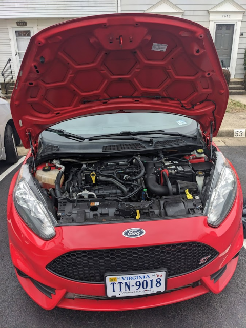

Haven't updated my build thread in a while So Ill break down a list of everything I've done to the car since I got it last December.
Sync3 swap
Backup camera
Coolerwerx shifter
BA intercooler
Koyo radiator
TB crash bar
DNA control arms
DNA swaybar links
Eibach front/rear swaybar kit
BC coilovers
ST200 intake
Whoosh induction tube
Mishimoto catch can
Radium catch can
Euro headlights
Wilwood brakes
Focus SVT rear brakes
Stock gloss black wheels with 205/45/ZR17 pilot supersports tires
Whoosh front subframe alignment dowels
COBB GESI catted downpipe
MBRP exhaust
Recaro seats
Heated seat wire harness
T
168
399
lorton, VA
Thread Starter #32
The Fiesta is pretty much setup the way I want it for now. When I get back from my trip I plan to focus on making the CRV a clean and smooth ride. It needs new motor mounts and the hood needs to be recleared. I also want to service all the dirty fluids on it. Next year I do want to continue the Fiesta build though. The plan is to go S280 with an Airtech manifold. Ill pair it with some XDI fuel upgrades. +50% injectors and pump. Not sure if I want to do the regular or EVO pump though. Id like to make the car E85 ready. Ill pretty much keep it stock block so no more than 350 wheel HP. The CRV will remain stock aside from a short shifter and Android headunit.
