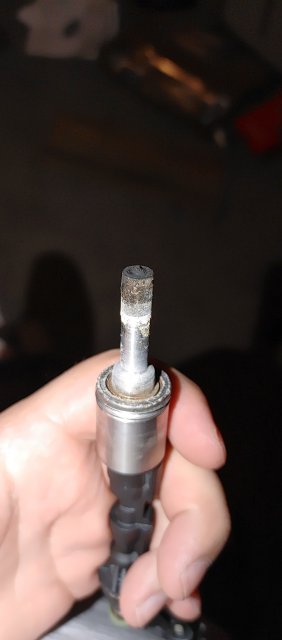

Took the first injector out, I am the first owner of my car, bought it brand new, I use it as a fun, race around car, don't drive it in the winter. It has 21,xxx miles on it. Look at this injector.... 20210720_000212.jpg

Took the first injector out, I am the first owner of my car, bought it brand new, I use it as a fun, race around car, don't drive it in the winter. It has 21,xxx miles on it. Look at this injector.... View attachment 42186
I've been telling people...Use a DI injector specific cleaner and a good oil. These injectors take a beating BIG TIME* I'm really wanting to peak at mine also next time I do the plugs to see how well the cleaner I have have been using is doing along with the 4 port injection Aux fuel system with keeping the valves clean.

I've never used any injector cleaner, and the car has never idled rough or stumbled ever and I've only run amsoil
