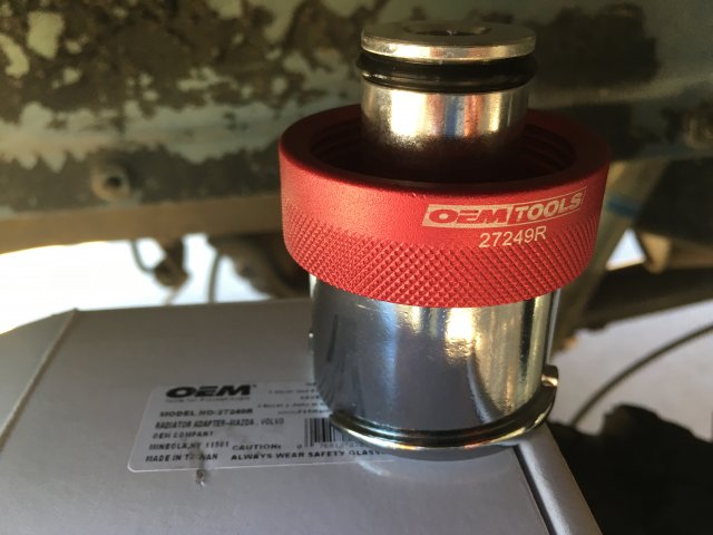

I ordered an “OEM tools” (looks like high grade Chinesium) from Summit Racing just because I know it will get here quick. Hopefully Wednesday I will know what is leaking!

I have the OEM Tools Vacuum Filler. It actually works well once you put a bit of electrical tape on the overflow port on the tank. However it will NOT pressurize the cooling system. Hope the tool you purchased was an actual pressure testing system. Any time when dealing with something made in China you need to quadruple check what the ad blurb says and cross your fingers that it was mostly correct.

I did find a pressure tester adapter that is a direct screw on fit. OEM tools 27249R.
