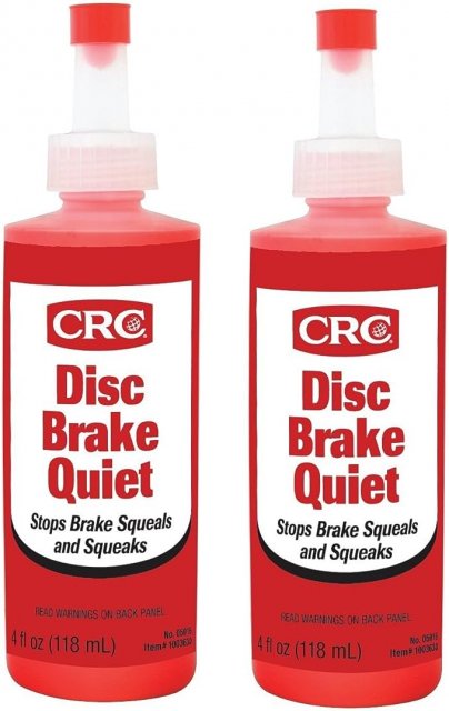

The squeaking is vibration. I always apply a coating of this across the back of every new brake pad I install and I never ever have any squeaking. I apply it even if there's some antivibration plate on the back of the pad. I'll squeeze a little between the steel plate and the pad. It's like silicone only designed for brakes.
