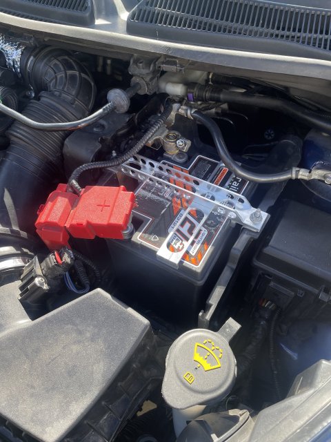

I'm really happy with the Braille 21lb battery I got for $223 from Tire Rack - it basically fits well in the stock battery box, very slightly higher than the stock battery, You could probably set it in with the stock battery tiedown and it wouldn't go anywhere, The crazy custom tiedown I made was mostly for kicks and a bit overkill with tabs to positively restrain the battery, not out of necessity. Somewhere between 5 and 11 lb lighter than the stock 96R (depending on brand and type - the Motorcraft is listed at 30-32lb depending on who you ask), and much lighter than the Odessey at 40lb
The 21lb is meant for starting V8's, and still has CCA of 550, similar to the stock battery. It only loses out a little on Ah/Reserve Capacity(32Ah vs 50-55 for a flooded 96R), so its a good idea to start the car at least every week or so. And its an AGM with a long cycle life, so it should last a while
I probably could have gone significantly lighter (15 or 17lb which are shorter by about 5/8") and still have a reliable battery for a daily driver, but the 21lb fitting well in the stock battery tray was quite attractive - it just happens to sit well even with the battery tray being weird in the middle. Most of Braille's offerings are right hand positive for some reason - not complaining. I do need to go back and clip/readjust some of the zip ties on the wiring harness, as its a bit of a stretch to get the positive over the terminal.

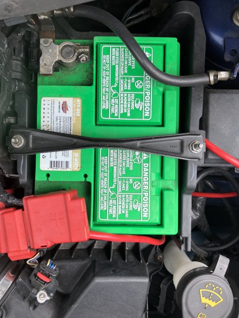

I’ve used Odyssey and they are very good. But, I have had zero problems with the Interstate brand. The Interstate are easier to find out in the big bad world. Because a battery rarely fails at a convenient place or time. 69D25573-14A7-41C8-B97C-579E0B4F5485.jpeg

I’ve used Odyssey and they are very good. But, I have had zero problems with the Interstate brand. The Interstate are easier to find out in the big bad world. Because a battery rarely fails at a convenient place or time. View attachment 56734
That particular Interstate battery, the MTP-96R, was going to be my first choice if I didn't get an AGM battery. I have also had good luck with Interstate, and I wish they made an AGM battery in our Group 96R size.
I wanted an AGM battery mainly to avoid the possibility of spilling, because there are a lot of electronics near the battery, and if it spills it's really a nightmare.
