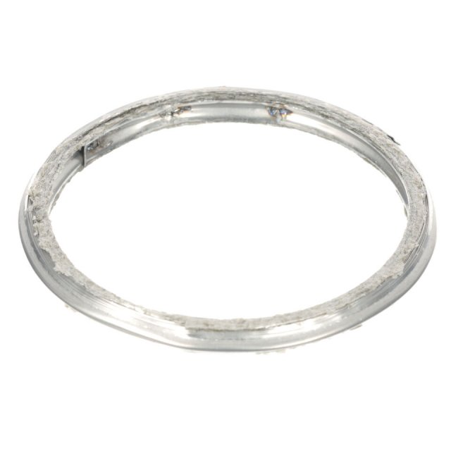

Hello Everyone!
Recently obtained a Big Boost Stage 3 turbo kit from a friend after he transferred to an S280. He made the transfer because the manifold kept separating from the turbo causing a massive leak. I’ve reached out to Big Boost 3 times with no answer back. I’ve since replaced the hardware, along with lock washers and a new gasket I made out of bulk material I found. Has anyone had this similar issue? If so, what was your “fix.” I liked this turbo a lot and would like to run it without the possibility of a leak. Thanks!

Are you talking about the gasket from the discharge side of the exhaust manifold to turbo inlet? I went to the website and saw a pic. It shows the turbo and manifold together. Is that the way it comes and if so, is it a stock Ford manifold? If it is a stock manifold, there is a "fire ring" that fits into a circular recess and it's a high temp ring gasket. The pic below is the fire ring and the link is to a parts diagram. The part is number 2. Also, if it is a stock manifold, I'd use the OEM nuts. I've not heard of people complaining about those nuts loosening. The only nuts that I know are a problem and the turbine side case nuts loosening and that is not your issue.

ya it’s the stock ford manifold, issue i have with the fire ring is that it doesn’t have the actual insert it’s supposed to sit in on this turbo since it’s a modified 4 bolt Garrett flange from big boost.
ALSO thought I should ask, which would be the best gasket material for this project? Unsure of what could withstand that much heat other than the OEM fire ring.
