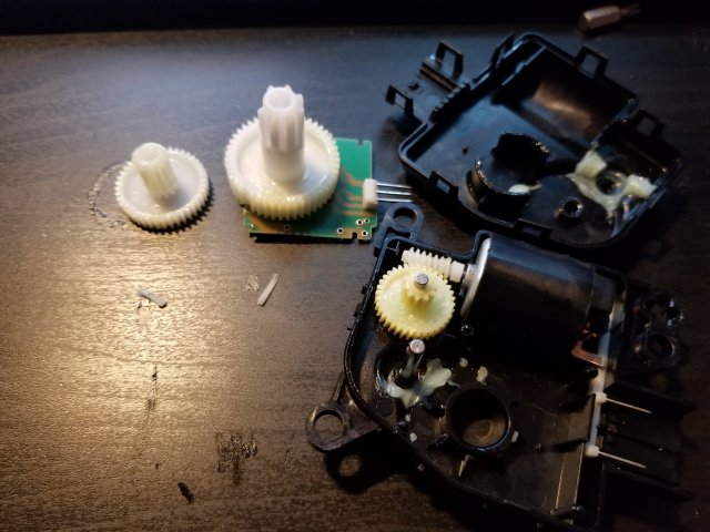

Thought I'd share this here, someone from the forum is claiming this, my highlighting for emphasis:
"The issue is not a gear, the issue is shitty traces on a circuit board. The design of the part drags metal across a thin trace on a board to get a resistive reading. This reading tells the chip how far it turned. The traces get worn down or dirty and the reading gets worse, so the chip turns too far and the gear starts skipping because it doesn't know where it is. The best corrective action is to get one with a stepper motor and predetermined distances without the stupid dragging design. The Dorman replacement makes this correction.
Wish I knew which brands did this or not, or if just Dorman... I believe the Dorman part # is 604322

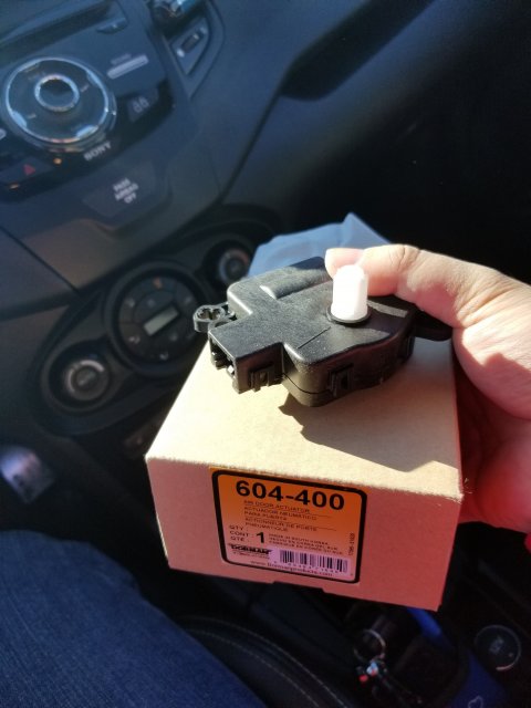

Dorman 604-322's external knob thing is too large / not the correct shape.
Well I just got confirmation, from the person who supplied the info above, that it's really it and is on RockAuto as well, as far as the A part anyway... So not sure if A or B is the one that most commonly fails.
