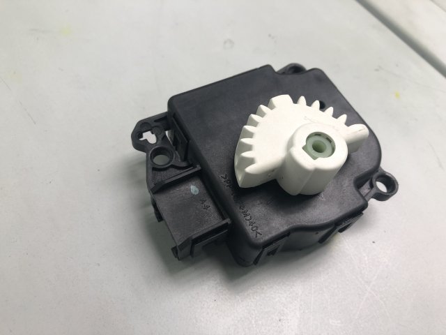

So i got the clicking start a few weeks ago, usually turns off within 20 seconds or so, but when i switch between defrost and air-to-face it starts clicking again. also happens when i turn the recirculation on. I even heard it clicking after i had turned the car off and was unloading groceries a couple mins later. i saw on rockauto there is a part labeled:
FOUR SEASONS 73242 {#BE8Z19E616A} Air Door Actuator Info
Recirculation Door (Controls Recirculate or Fresh Air Option)
Has anyone replaced this part vice the MOTORCRAFT YH1896 {#BE8Z19E616B}

Is this the same blend door? Sounds like a woodpecker, center dash
Yes, that's the driver side one that's a pain in the butt to change. Mine sounds exactly like that.
The passenger side one has a slower click, at least when it failed in my car 10K miles ago.
Well, at least I know the problem now... should be fun! :poop:
