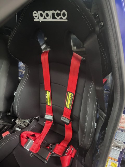

Which one for the wheel? And what about the wire/plug on the seat belt, does that not cause issues?
It looks like this one: NRG SRK-RES OFF ROAD PAIR STEERING WHEEL SRS WARNING LIGHT BYPASS RESISTOR KIT https://www.amazon.com/dp/B08HWX77Y9/ref=cm_sw_r_cp_api_glt_fabc_KV94KHTK58G68YPV40ZD
Regarding the seatbelt, I plugged everything back in and inserted one of these things to make the car think the seatbelt is fastened: Car Seat Belt Clip, Anceev Universal Seat Belt Buckle Auto Metal Seat Belts Clip 2 Pack https://www.amazon.com/dp/B08DBW8BJ...abc_YQ4BX2BAXQSFXDXAR5J5?_encoding=UTF8&psc=1
