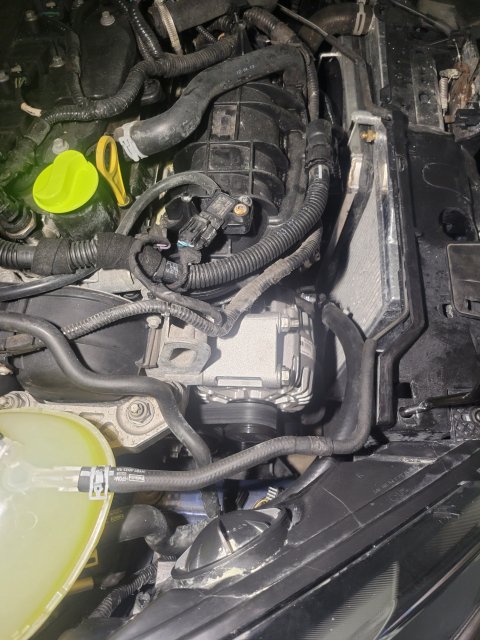

Alternator wasn't just bad, it was seized or something. Not 100% sure. Got lights on dash, then lost gauges, then lost power steering. Started smoking and sizzling like crazy, cracked the hood and sprayed an extinguisher underneath. Not sure if there were ever truly flames. Opened the hood and the smoke was very clearly coming from the alternator. In a tow as I type this. Going to replace the alternator tomorrow and start her back up and see what happens.

There was a small piece cracked off the alternator, I suspect that it worked it's way inside and caused havoc. $250 later and I'm back up and running. Battery tested good and new alternator didn't catch fire in the 2 mins I let it run so that's a plus. Alignment tomorrow, car show Thursday, track day Saturday. Still have to do a lot of cleaning to get the fire extinguisher powder out from all the crevices.

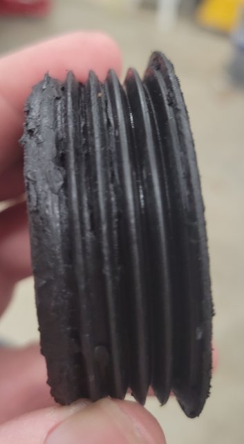

Can't win, belt broke on the way to alignment. No idea why. Is too much tension a thing? Getting towed....again. New belts en route.

Were you using the same belt that was installed when the previous alternator failed? Did it show any signs of wear before snapping?
Yes same belt. It didn't actually snap, just frayed/etc. Have not looked super close yet. No visible signs of damage but I didn't pull it all the way out either. It looks like the idler/guide pulley that is hanging off the alternator didn't get installed straight (by me) and that might have thrown the belt off line just enough to cause wear. Not sure yet.

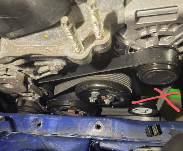

Thread Starter #176
Found the culprit - the tensioner pulley was in bad shape. I suspect this happened from the original accident. Ran to the auto part store and got a new pulley even though it was slightly bigger. I ditched the idler pulley on the alternator (red x indicates where it would go). Should be good to go now.
