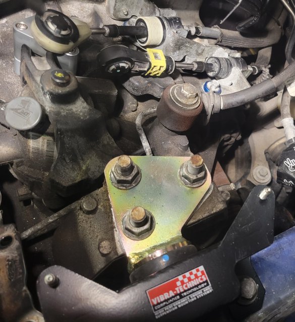

Installed Vibra fast road trans mount as well as the Whoosh short shifter plate and trans side bushings. Engine bay is super dirty but I don't care. Bushings were tedious but they went in. As I button up the engine bay, I'll be installing a Mele battery box, a 15lb Braille battery, and a Whoosh crossover/induction/intake pipe. Once that's done, I'll shift (heh) to the interior and install a modded OEM lever and shifter base bushings. Hoping once it's done that it's 75% of a CAE shifter for 7.5% of the price.
It'll be interesting to see how the Mele box will work with the Vibra fast road trans mount. I installed one and liking it so far but their site stated that it only works with the stock mount.
On the other note, if you are looking for even lighter battery at a reasonable price, I transferred the Shorai Lithium Battery LFX36L3-BS12 Lightweight Powerful from my other project car to the Fiesta. It's a tight fit for the Mele box but it fits and weighs only about 5lbs. I had it for about a year and it survived the Phoenix area summer temperature. Not sure how it'll do in a cold climate as Lion batteries don't do well in the extreme cold, but sounds like you won't be driving the Fiesta during the winter anyways.
Already installed it. The box/mount weren't an issue at all. The only issue I have is trying to get the ECU mount to sit flush/flat against the box. I kinda wedged it and zip tied it for now. I got the mount and battery super cheap used. Wasn't really actively looking for this setup but found a deal.
