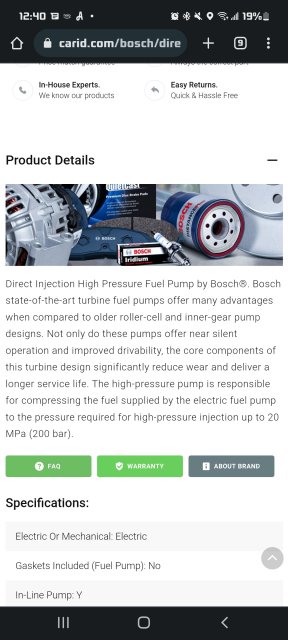

I don’t think we have a turbine pump. I think that article describes all Bosch injection pumps(or just the turbine pump)
Yeah, that screen shot is describing an electric pump. Ours is definitely mechanical.

My only concern with bosch's description is that even when describing our oem pump (69893) it classifies it as a 200 bar hpfp. So I'm not sure if it's a blanket description for all bosch hpfp
