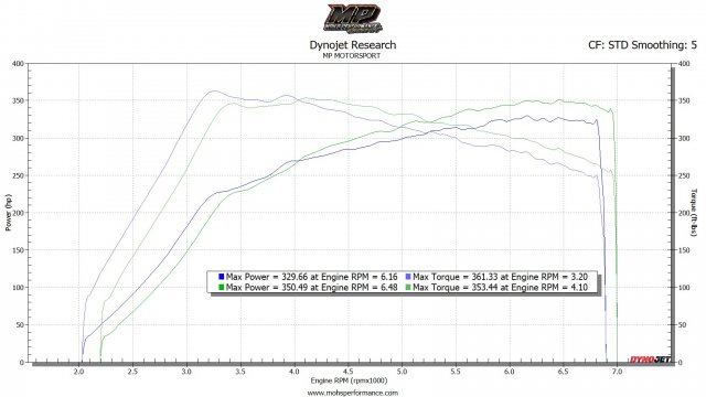

𝐁𝐚𝐬𝐞𝐥𝐢𝐧𝐞 𝐭𝐞𝐬𝐭𝐢𝐧𝐠 𝐨𝐧 𝐭𝐡𝐞 #trashfiesta 𝐢𝐬 𝐝𝐨𝐧𝐞. 𝐏𝐥𝐞𝐚𝐬𝐞 𝐫𝐞𝐚𝐝 𝐞𝐯𝐞𝐫𝐲𝐭𝐡𝐢𝐧𝐠 𝐛𝐞𝐥𝐨𝐰 𝐛𝐞𝐟𝐨𝐫𝐞 𝐥𝐨𝐨𝐤𝐢𝐧𝐠 𝐚𝐭 𝐭𝐡𝐞 𝐝𝐲𝐧𝐨𝐠𝐫𝐚𝐩𝐡!
The point of these baselines are to test a few new things I have been developing with the stock fuel system. This is all in the ECU and requires ZERO hardware changes. This is something I have been wanting to try for awhile that is only applying to the Fiesta ST, other vehicles we support do not have the same ability to run these changes.
I wanted to test a few theories of mine on our own personal vehicle before applying them to any customer's vehicles. It took awhile because of Covid-19 but now things are starting to open back up I can get to work.
On the graph you see two power numbers (First picture):
𝟯𝟮𝟵.𝟲𝟲𝘄𝗵𝗽 / 𝟯𝟲𝟭.𝟯𝟯𝘄𝘁𝗾 - 𝗚𝗿𝗮𝗽𝗵𝗲𝗱 𝗶𝗻 𝗕𝗹𝘂𝗲 - 𝟮𝟲.𝟱𝗽𝘀𝗶 𝗧𝗮𝗿𝗴𝗲𝘁
This is what the car made with our new tuning changes while still being able to hold a conservative AFR. On E40 and a bigger turbo with turbine backpressure and an appropriate exhaust side, we target around 12.2-12.5:1 AFR on GDI engines. On this pull the AFR was flat through the the entire pull and only trended up as the throttle was starting to close in preparation for the rev limiter. (Second picture)
𝟯𝟱𝟬.𝟰𝟵𝘄𝗵𝗽 / 𝟯𝟱𝟯.𝟰𝟰𝘄𝘁𝗾 - 𝗚𝗿𝗮𝗽𝗵𝗲𝗱 𝗶𝗻 𝗚𝗿𝗲𝗲𝗻 - 𝟮𝟴𝗽𝘀𝗶 𝗧𝗮𝗿𝗴𝗲𝘁
𝑳𝑬𝑨𝑵 𝑻𝑬𝑺𝑻𝑰𝑵𝑮
This is what the car made with the same changes but with another 1.5psi of boost (averaged), and a slightly more aggressive AFR target of 13.25:1. The power gain is from the added boost, the more aggressive AFR target was just to see how the car responded and allows us to extend the fuel system out a little further. (Third picture)

The Fiesta doesn't have what it takes to sustain extreme lean conditions near 14:1AFR but 12.5-13.0:1 AFR will likely not be out of the question with a little more ethanol and our fuel system upgrades, which is coming next.
Another point of this dyno testing was to get some numbers for the Turbo Technics S280 turbo upgrade. A lot have seen my tech video on this turbo, and the install videos I did, but we are just now getting around to actually testing it out.
The turbo is doing extremely well. Seeing 28psi by 3500rpm and holding strong all the way to redline. This is even with the stock actuator the turbo ships with, not bad. Being that we saw a 20hp increase with just 1.5psi with zero timing changes between the 330whp and 350whp run. I think this turbo has a solid 380whp in it with the fuel system changes, a little more ethanol, some more timing, and sprinkle in a little more boost. That is some good power for a turbo so responsive and is still 100% bolt-on.
