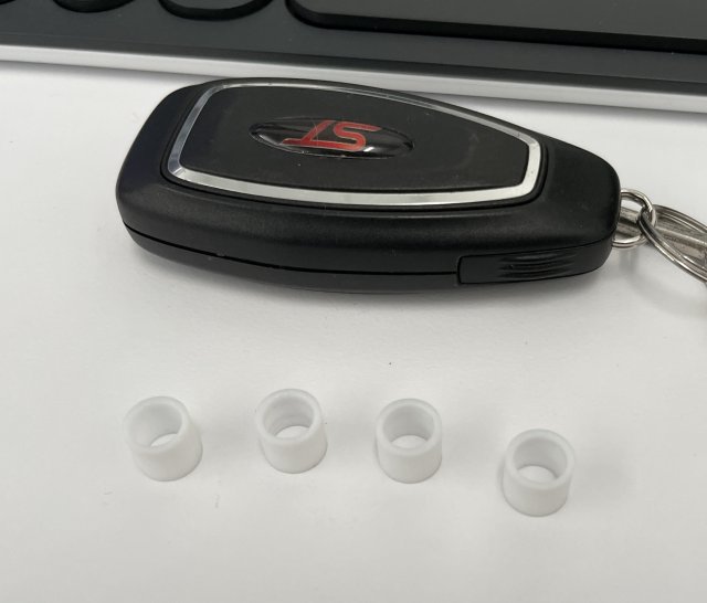

One step closer! I picked up some old stock injectors to mess with so I don’t have to scrap the expensive jag injectors setting up the modification process. Hopefully I’ll have time next week to start modifying them. In the meantime I made some new injectors seals. I didn’t like how Pumaspeed just doubled up on the stock seals and decided it would be better to have one proper length seal instead. I also made them about .002” oversized on the OD to ensure a good tight seal.

When this is all said and done, how much do you want for a set of seals?
I haven't really thought about selling them yet, but I suppose it's a possibility. There would have to be a pretty good demand for them since I'd have to make several sets to get them down to a reasonable price. Making just the one set took me a couple hours but most of that was machine setup and measuring cuts. Additional sets would probably take 15-20 minutes to make once the setup is done.
that actually sounds like a profitable go. You could always also think about wholesaling them if you grew tired of trying to market them to the public.
Assuming it works, would be awesome if you did it as a group buy. Make it easier for you to run multiple at the same time instead of doing several changeovers and a good gauge of what demand might look like. I’d definitely buy a set or two. Love the idea of making them yourself whether you decide to make more or not. Looking forward to seeing how they do for you
