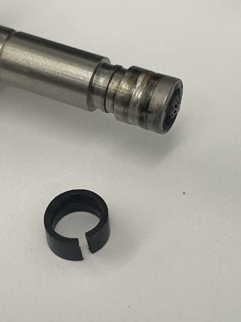

I finally had a chance to modify a stock injector. The good news is they cut well, the steel is surprisingly soft. The bad news is the assembly is way off center (by machining standards) and there isn't an easy way to hold the injectors centered on my machine. So turning down that section accurately is going to be a challenge. If I had a bigger lathe that could fit the injector housing inside the spindle that would solve that issue but my lathe only fits 1" diameter. The other bad news is the seal isn't as simple as I thought and I'll probably have to remake the ones I made a few weeks ago. You can see in the photo below what I'm talking about. I have options for dealing with it so it's not the end of the world, just complicates things a bit.
I wouldn't be surprised if most of the seal failures we see are coming from the unmodified Jag injectors. Pumaspeed modifies the injector and puts a second seal on the shaft above the original seal. They claim that if you don't do this, you're only getting a small amount of seal engagement on the unmodified injectors. Would be awesome to get my hands on a modified Pumaspeed injector to see how exactly they modify them. Maybe one of our UK members can find an old one and cut the seal off to get some photos?
This is a stock, unmodified Fiesta injector with the seal removed:
