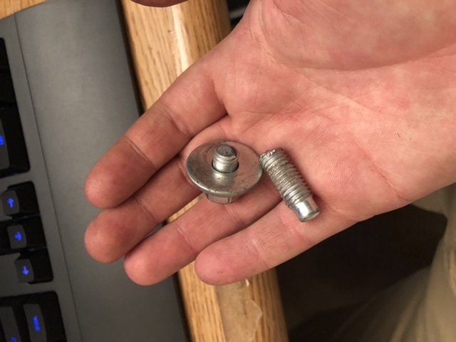

I broke a bolt that hold the passenger side motor mount to the the frame. Any suggestions on the best way to remove? Also a part number for new hardware?

Also, I'd drill and tap it. If you can afford it, use Cobalt drill bits or high speed steel.

Here is a pic of the broken bolt. It’s one of three that hold the upper mount to the frame. I was careless and in a rush and just cranked it down. Let’s just say I learned my lesson on following torque specifications. I ended up getting the broken piece out with a hammer and a sharp flathead screwdriver.(Hitting it in a circle until I could grab it with some pliers) This was after breaking a few drill bits trying to tap it. Then went and got 3 new bolts from the store and bam good as new. All this for putting in the power flex insert and arp bolt. Also huge thanks to the gf for holding the flashlight and thanks for the quick replies!
