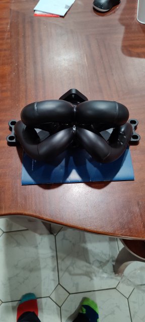

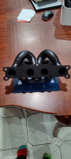

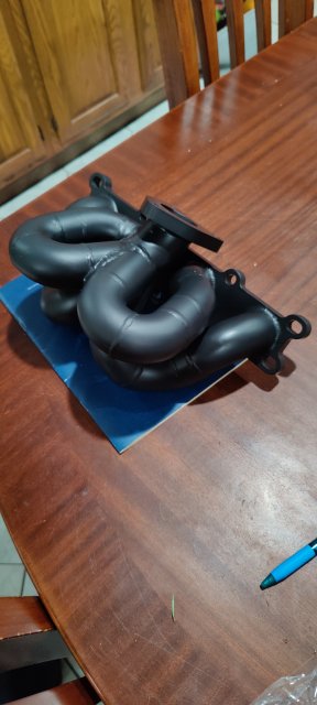

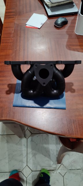

@Mighty Mouse that's the company I'm going to for my AET manifold and s280 turbo housing. Do you mind posting pictures and your thoughts on the finished product when you get it back? I was gonna go all black cause i just assumed other colors would be more.
I'll be happy to post pictures. Its worth it just to see the weld porn on the airtec lol. So far i have been happy with them but I will report back once everything is finalized. I'll also post my report on the thermal difference before/after with underwood Temps and charge air Temps
