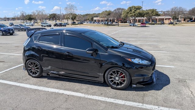

I just recently purchased a 2016 Ford Fiesta ST with a good amount of mods to them. Right now it's running on 93 with no issues, there's an E85 gas station within a few miles of my house and the fuel system is already ready for E85, I just need to get it tuned for it right? I'm new to the whole COBB tuner so I'm not sure what I need to do and don't want to blow something up. I've been trying to contact tuners, but they either don't do Fiesta's or just won't since it's online. Any help would be greatly appreciated! I can provide a mod list if that makes things easier.
