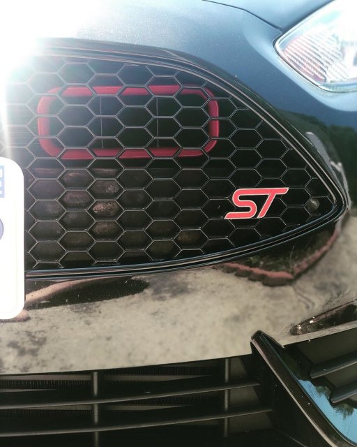

#10279
387
291
That's also a bit why I'm on the fence too. All my mods so far have been reversible given enough time, but you can't uncut the shroud.
But you can just buy another one should you choose to go back but I’m running the stock air box with a big mouth and IMO I say do it. Besides the added benefit of pressurizing the air box at speeds (with cooler air) so the intake doesn’t have to draw from a vacuum it looks dope af
