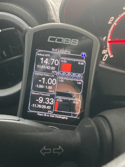

I have a boost leak and I thought it was the Whoosh intercooler that was damaged in a wreck. I swapped it out for a stock IC and it still will not go over 14psi. In addition, I can hear a leak while accelerating down the on ramp at WOT with the windows open. All the clamps are tight so I'm wondering if the cap on the cold side pipe boost gauge tap from the IC to the TB is busted somehow. I used to get 23.88psi

did you check your BOV?

I know they are known to leak, but I'm not sure if they tend to fail around the mounting bolts, or if its the valve itself that doesn't close and leaks.
I would pull it off and inspect it at least
