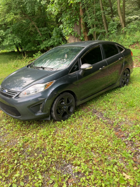

Continuing my sedan ST build here from the new member post. I am not the first.
