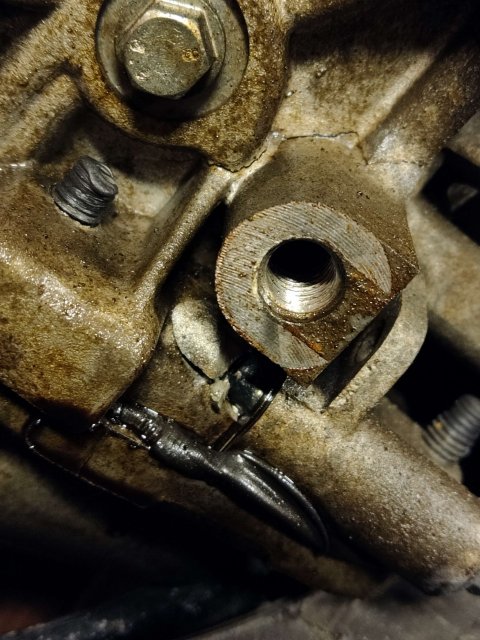

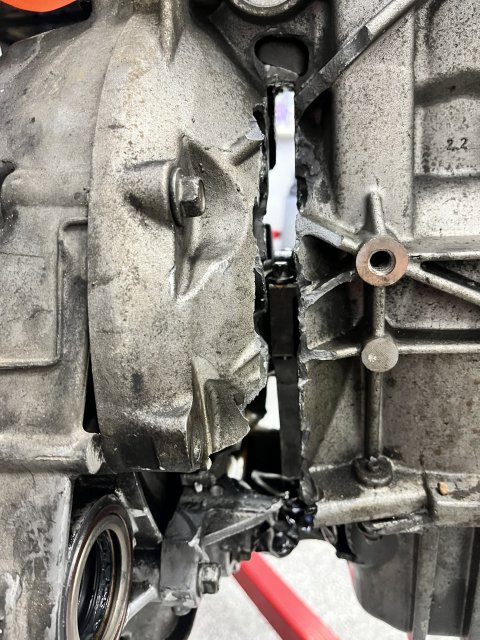

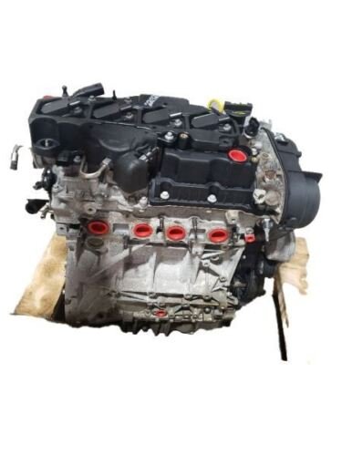

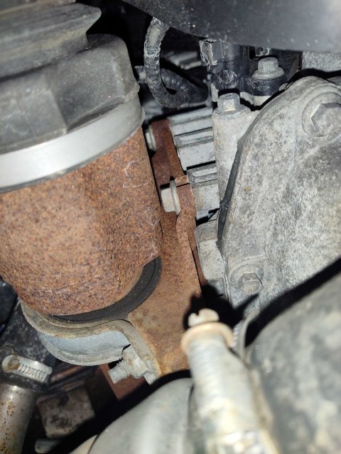

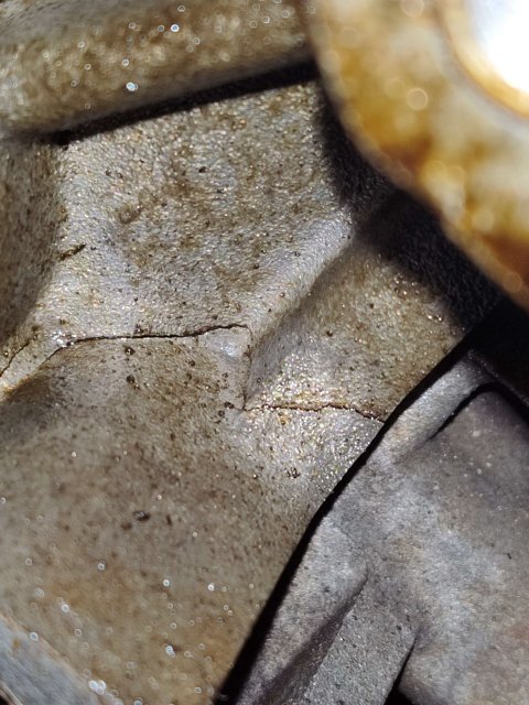

Not a great up-date to this thread.....
I bought an engine semi-local to me (via ebay),
in case the head gasket swap didn't work out,
and the "new" ebay block is cracked
bad crack:
worse crack:
and the missing axleshaft boss I should have noticed in the (small) ebay pic:
ebay pic:
I don't know how anyone can sell an obviously broken engine like this.
The seller seemed OK (250 miles from here, 20k feedback, 99% positive),
and the price was right ($1,670.85 on ebay + $250 freight for a 69k mile Fiesta ST engine)
I picked up the engine from the freight office on 12/27, but didn't get a chance to go over it until today.
We are still within the first 30 days of purchase, but just barely.
I am going to write up a very polite message to the seller about returning this broken engine.....

Thread Starter #14
I messaged the seller,
we'll see what happens.
unfortunately its a long weekend in many places,
hopefully they're working Monday,
I'll deliver it in person if necessary.

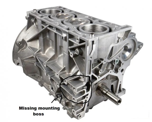

This is a pic of what the mounting boss should look like:
and here's a pic of what the bosses are used for in the vehicle (bracket for axleshaft):

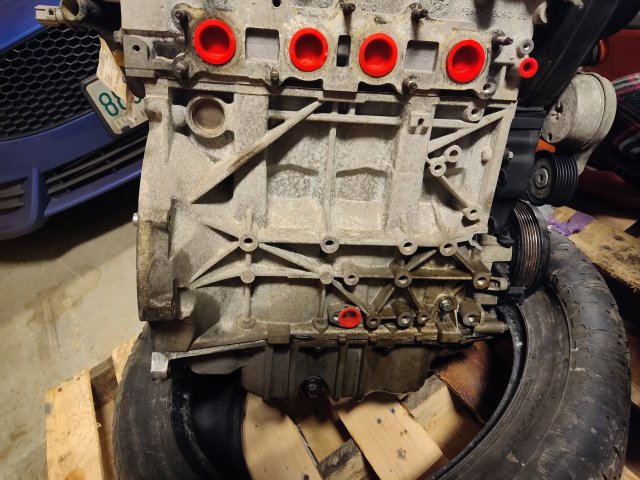

And a pic of the ebay engine from a little more distance for perspective:
^this was the side facing down on the tire during shipment, so even when you unwrapped it, it wouldn't be visible until you physically lifted the engine up to look under it.

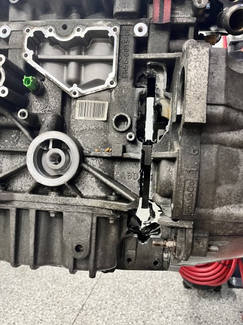

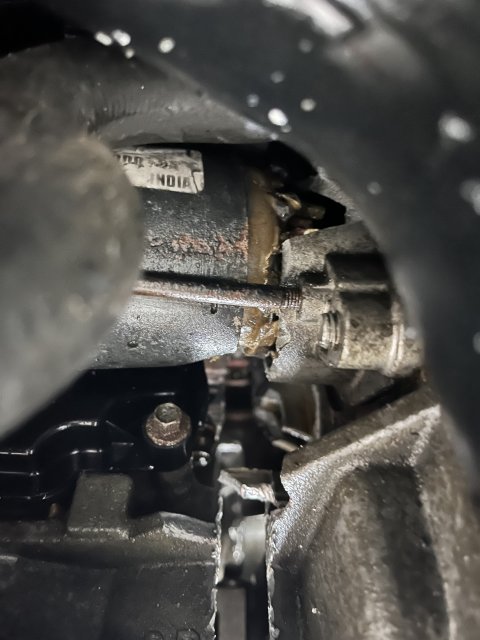

You might have seen mine on FB …. Rod #4 broke at the track and buzzsaw’d the block, oil pan, and starter.
I was 118 MPH when it blew. Oil and coolant hit the back tires, and I went spinning. The gravel trap saved me.
