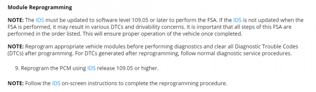

Reading through the procedure it says the following:
I'm assuming by reprogramming the PCM I'll get the lower rev limit. Also, in a rev limit string I read a month or 2 ago at least one guy said when he got the car back it had the lower rev limit. I could ask them to skip that part but I bet they'd either refuse or promise me they'd skip it but go ahead and do it anyway - I don't want to risk that.
