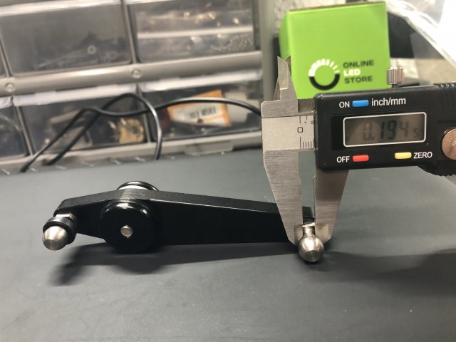

Are the ball studs the same diameter thread as the old version? Did they explain how this solves the problem? I still can't understand how this would fix the issue...
I’ll measure it for you. One sec.

Notice the old dogleg design in mine above. Here is the new version you have to get directly from Coolerworx. It took a lot of following up to finally get them to ship these. Communication is poor. Mine hasn’t broken, but it was absolutely necessary to have the new parts available in the event the shifter breaks during a track weekend. The shifter feels phenomenal but I’d buy a CAE or wait for ZeroPointOne to finish theirs if I did it again. I can’t stand businesses with shitty communication.
I'm glad to actually see the new part separate from the shifter, it confirms that my shifter has the new setup. If you install the new part, I'm curious how it changes shifter feel. There's definitely something a little odd when you pull it over to first and second

Thanks - but what about the thread diameter? Can you eyeball it with the calipers without removing? If it's 6mm, they haven't changed the ball stud at all. I don't understand how this is an improvement, I am actually baffled.. Hoping someone can chime in and explain why this will fix the issue of the ball studs shearing..

It’s the same as the old one from what I can tell. I’ll confirm when I swap it out but that’s gonna be awhile. I bought the balls you listed and it’s definitely not as thick as they are.

What you could do once you swap out, is have your buddy carefully drill/tap the old linkage for the bigger studs. And then have him weld them in to reinforce them (there isn't much material left for the larger ball studs with the CW aluminum linkage). Obviously this may present a challenge due to dissimilar metals but you may be able to get creative for a reliable solution on the cheap as a backup linkage.
If the ball stud shears at radius between the end of the ball and the start of the threads, changing ball diameter shouldn't make a difference. The small 6mm cross-section would remain.
Perhaps they went to an off the shelf part with a larger ball/same 6mm thread, but some improved heat treat/coating? If so it's not obvious from looking at the photo above. :unsure:
