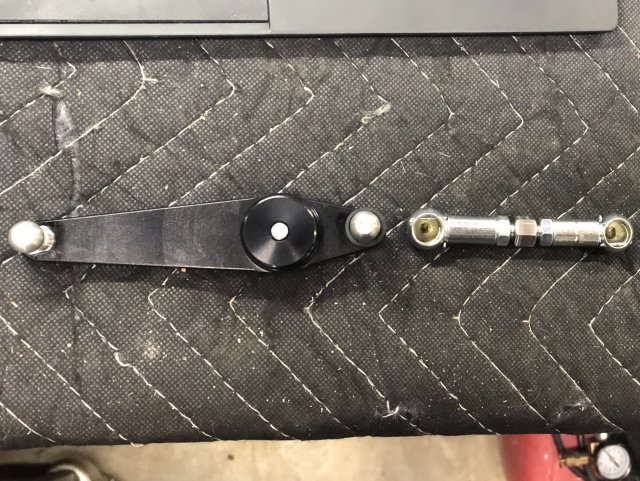

Edit: I was given incorrect information. I received a shifter after 1/1/20 with the older angled linkage (see pic of the new straight design below). It required many, many emails to Coolerworx to acquire the updated parts. Whoosh does not provide replacement parts so be aware. It could take a long time to get the replacements, if yours breaks. Though mine hasn’t broken, the design is flawed. I absolutely love it but if I did it again, I’d buy a CAE for peace of mind. There’s a UK company “ZeroPointOne” designing one now as well. Here is a pic of the replacement parts:
THIS ORIGINAL POST IS WRONG — PSA: Shifters after Jan 1, 2020 have the newer design. I have a newer one. I’ll keep an eye on the YouTube fella’s issue. So far, it’s been flawless.

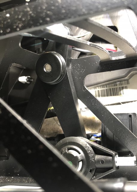

Mine was shipped after 1/20 and it’s the old version. Who knows man... The linkage I have is more of an elbow, not straight. 8693EA06-C69D-4A4C-9533-79B7FDAD08DC.jpeg

Notice the old dogleg design in mine above. Here is the new version you have to get directly from Coolerworx. It took a lot of following up to finally get them to ship these. Communication is poor. Mine hasn’t broken, but it was absolutely necessary to have the new parts available in the event the shifter breaks during a track weekend. The shifter feels phenomenal but I’d buy a CAE or wait for ZeroPointOne to finish theirs if I did it again. I can’t stand businesses with shitty communication.

Are the ball studs the same diameter thread as the old version? Did they explain how this solves the problem? I still can't understand how this would fix the issue...

That's a shame. I'll be taking my off soon. I love the feel but it's not worth the risk.
