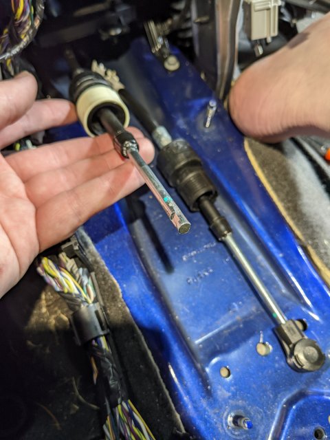

Hey guys,
I was installing my CoolerWorx shifter the other day and ran into a snag. Looks like they redesigned one of the ball/socket connectors and I was wondering the correct way to install it? See the attached picture. The other side just snapped on like in Spark Plug Steve's video..
I've seen the install of a CoolerWorx shifter on a Focus and they had to cut off the socket connection and install a different connector with set screws. It kind of looks like I might need to cut off this socket connector and attach it directly to the shifter with the set screws?
I reached out to Ron but I think he's still waiting on the new installation instructions from CoolerWorx. I also reached out to CoolerWorx, but from what I've read it takes forever for them to respond (if you're lucky).
Anyone have any thoughts/opinions? I really want to get this installed, lol.

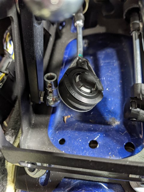

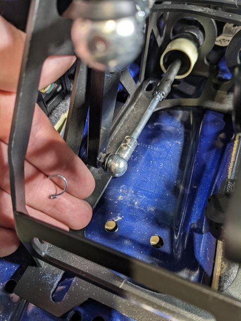

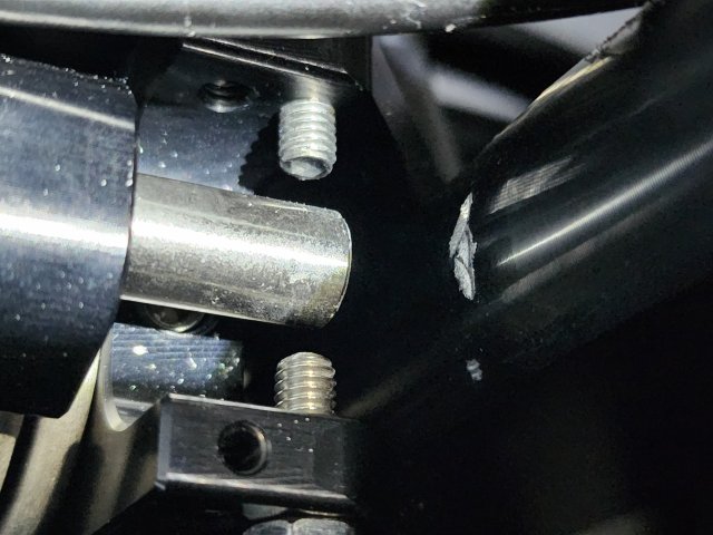

Hey guys,
Got this installed over the weekend. I'll attach some pictures below, but there's a clip that keeps the set screw/socket half of the connector attached to the ball of it. You have to cut off the plastic socket connector and attach the new connector with set screws. There's a flat notch on the rod to keep the plastic connector firmly attached - I put one of the set screws right over that flat spot with some loctite to make sure it won't come off.
Hope this can maybe help someone in the future!

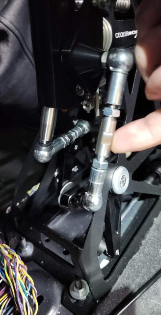

Bro its the two shifter adjustment shafts on the coolerworx shifter that connect to the cables. Adjust those two nuts until everything goes in smoothly. You will just have to play with it a bit, when you get it right make sure to lock both nuts on each side to lock in the setting.

Hey guys,

I'm baffled by this design, is it actually necessary to do this? I'm going to try and pop my stock shifter cable straight on the steel ball first, would hate to have to replace the shifter cable if going back to stock down the road.
I popped the stock plastic right on to the ball. I spent about an hour trying to figure out how to take that plastic piece off without damaging it it looked like it needed some sort of special tool to remove it. I'm sure it's some special tool with some name I never heard of. I would have loved to put the provided metal joint cap on that came with the shifter but didn't want to destroy the oem plastic piece. I already had to cut enough and destroy enough just to make the oem trim fit with this thing.

Did my install last night and Mjfist was right, you can just pop the stock cable end on. I emailed Coolerworx asking if this was possible and why they changed the design and of course did not get a response.
As a side note, I'm too lazy to remove the Whoosh short shift plate so I moved the ball end from 25% reduction to 15% reduction. At 25% I could not find neutral reliably. It feels good like this but I'm concerned about the additional leverage being applied to the ball ends, might remove the plate later but it's drivable like this.
Overall install is pretty easy if you reference spark plug Steve's video except for where he bolted the base on before installing cables. Do the opposite; install the cable brackets, then put the cable ends on the steel balls, then pull the whole shifter back and set it on the studs. Getting the front passenger side nut on was difficult, the secret here is to lift the shifter base up a bit and slide the nut in from the side, then push the whole base forward and slap a long 10mm socket on the nut before letting go and tightening the nut. Hard to explain but hopefully that is helpful to someone struggling.

Had been putting this off for quite some time but decided to just do it. Buddy had gotten one but for his FOST and finally sold on it, though after finding this thread at the tail end of install as wasn’t sure how to get the shift cable’s plastic boot end fitting to anchor on which happened to be their “redesign” fix
So jist of it is` history shows prone part failure, non existent customer support on purchasing replaceable parts, or even responding back to inquiries, made me debate, though did not take to long as was already deep in to install.
No instructions from the company but Whoosh did offer a pretty detailed video which made it a breeze, except for the updated part which required cutting, and, frankly, will most likely fail as the design fix looks pretty flawed on these little set screws trying to keep the cable from slipping out.
I wish I had caught the solution on just popping stock cable end worked on the ball before I had already started cutting
Anyway, my cable had no notch or indenture really for at least one of the screws to have a stable hold. I can probably shave in one for now. Possibly a gear clamp on top of the blue Loctite on the set screws on that cable?
