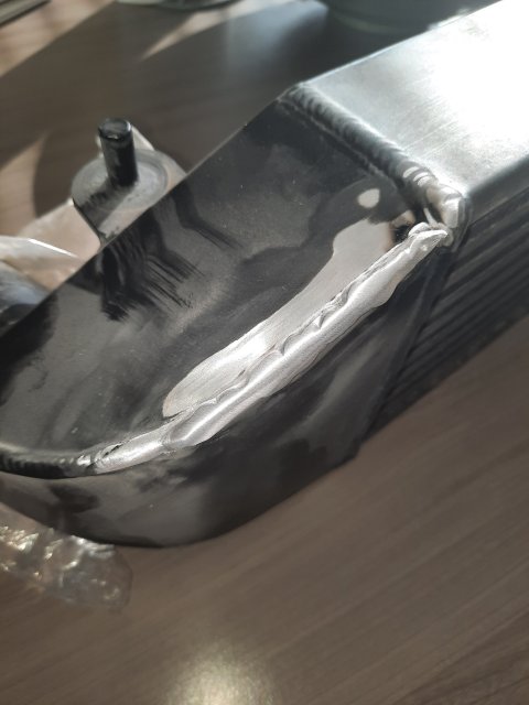

P006A and "Onderhoud nu" (translated in "Service Now" ) diagnosis and limp mode . Caused by a small crack in the intercooler input along the welding edge.
Is welding (TIG) an option ? Any tips?

Welded (TIG) , painted ( pictures attached) , assembled : P006A and P2178 do not occur any more during a 15 minutes test drive . Question remains if this was indeed poor quality OEM .
FYI: One of the first steps in the proces was changing the sounder box as there was a teeny-weeny little crack in the flexible tube going to the sounder box .
Fear that remains : is there 'something' that causes such a abnormal high turbo pressure ruining the intercooler?
A pitty that it is quite a job to get access to the intercooler, we should have noticed it much sooner. A smoke test was not done as no equipment and would also have revealed the culprit.

That is not an OEM intercooler. OEM end tanks are plastic. Glad you got it fixed!

Thank you for making the point. Now you say: no partnumer ( I asume C1BY-9L440-AD) was engraved which is unusual (even in Belgium). MEA CULPA Ford for daring questioning OEM quality.
