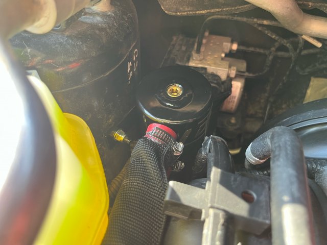

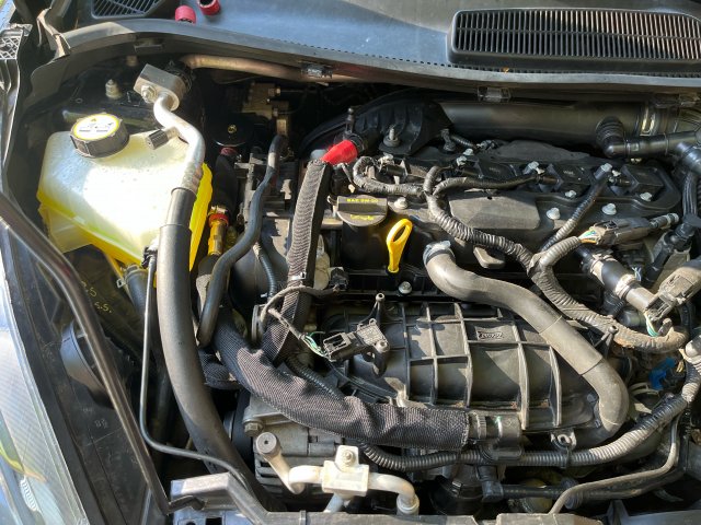

I bought one just to be on the safe side. I'll report back about how much it catches. It's not cheap so hopefully it does something to reduce buildup
Installed mine today. Install was straightforward, I cut the hoses so they fit nicely and won’t rub anything. I also got the protective sleeves which unfortunately cover up my nice red hoses.
So far I’m happy with how it fits and the quality of the parts.
