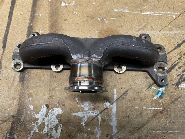

Quick post just to keep those interested updated. WOR manifold arrived as promised from Will and it’s a beauty. Super nice guy too and helpful as can be. Manifold is out getting ceramic coated and should be back by the end of next week. Mates up perfectly to the turbo and is considerably larger than the Vband adapter from ATP. Eliminates a potential leak point and flows more - all good by me.
Also said screw it and ordered a single port aux kit from stratified to push it to 300whp for little more than dick measuring because I wanted 300whp.
Sticking with Dizzy to tune but doing both 93 and e30 tunes this go ‘round.

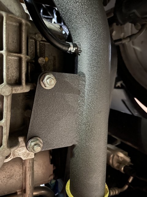

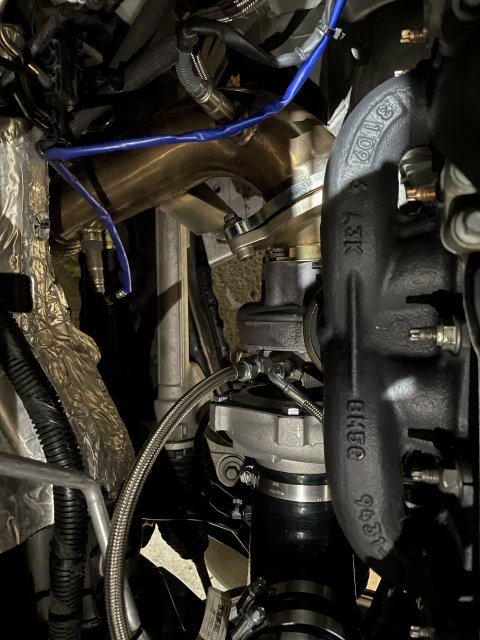

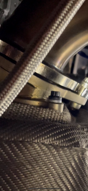

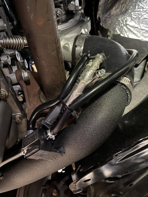

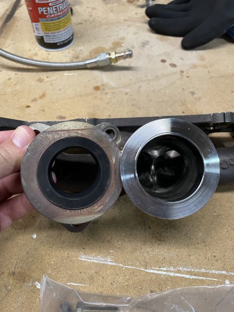

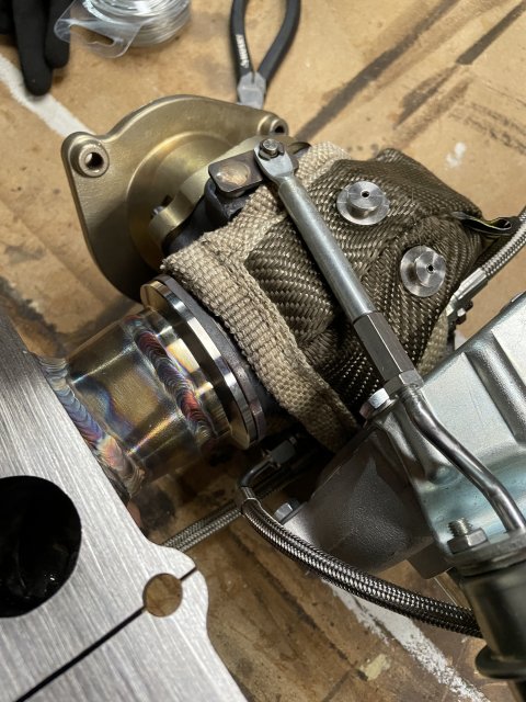

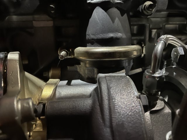

Finally back together, with a small asterisk that’s I have to take it apart again to dial back the pre load. Hit 23 psi on base map which is surprising because I only added two turns of pre load and was at 8 psi on the base map with Airtec manifold + ATP’s adapter. The increase in flow plus two more turns made a major difference. Let off the throttle due to over boosting but looks like it’ll spool a few hundred rpm sooner now.
Long story short - WOR manifold + ATP 2860 + mountune hot side pipe is the way. Everything joins together perfectly.

Turns out even if you've done it a bunch of times, you should still look at instructions. Plumbed the boost control solenoid backwards, hence the over boosting. Duh
Switched it around and only hitting 11 psi. Up from ~8 before by adding two turns of pre load, so going to drop the sucker and add 2.5 more turns and see what happens.

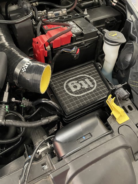

Started checking some things off the list. ST200 intake is in to replace the mountune, and have the Whoosh V3 catless downpipe out and ready to put catted version in.
Learned two interesting things.
My Mountune intake only has two of the four corners threaded. I thought I fucked the other two up because I’m generally ham fisted and it drove me crazy, hence the ST200. Turns out I didn’t, that’s just how it was. Weird. Will be in the FS section before long.
Second, learned that my V3 catless downpipe was incompatible with the 2860’s downpipe adapter. There was a gap there are that wasn’t present with the stock turbo. Convinced myself the turbo was the problem and it’d have to go back for a repair. Turns out the little inner lip is the issue. V3 catted downpipe doesn’t have the lip and mates up perfect.

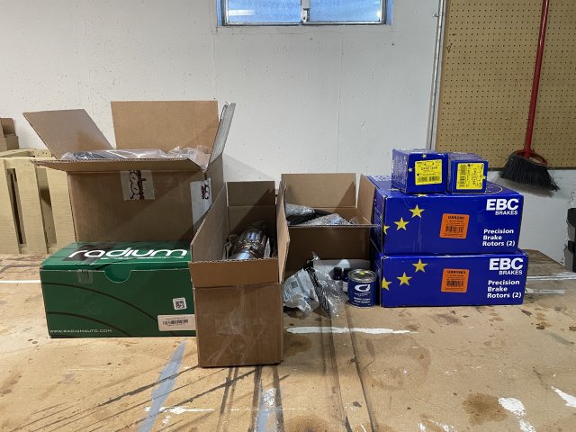

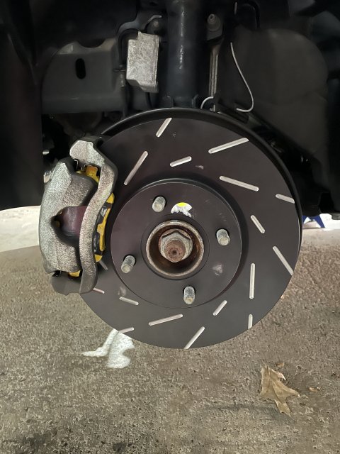

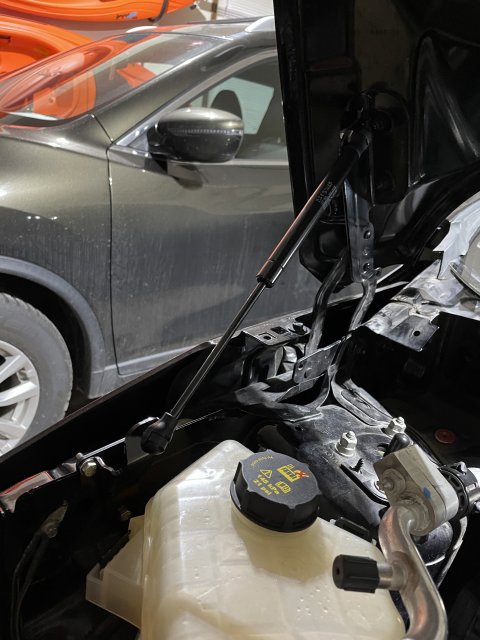

Bit more progress this week. EBC rotors and yellowstuff pads all around to replace the OEMs. Powerflex trans mount insert. Dark ice hood struts.
Also snagged a Cpe RMM to replace the mountune on there even though it’s only been on for 3500 miles. Wanted one a bit stiffer hopefully it fits the bill although I admittedly didn’t compare. I just assume everything is more aggressive than mountune.
