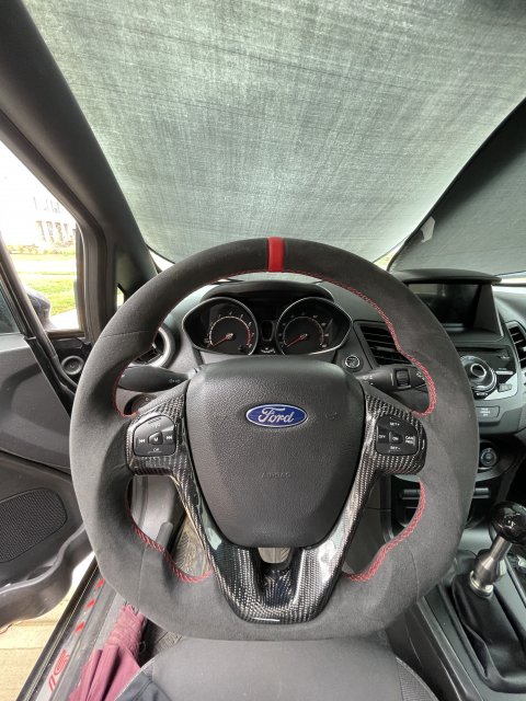

Been a while since I’ve done anything with the fiesta after my daughter was born. Finally got a few minutes to get a couple of things done.
Removed the OEM trans mount with powerflex race insert in favor of vibra-technics fast road. The race inserts feel great, but the amount of NVH is too much for me. The passenger side still has OEM mount + upgraded bolt + race insert, but will swap that for vibra whenever I have a few more minutes to wrench on it. I didn’t find the passenger side mount to add anywhere near as much NVH as the trans mount.
Also installed coolerworx shifter despite much apprehension after reading of multiple install horror stories and failures. I have nothing negative to say about the install or operation of it given I’ve only put 80 miles on it. Install was very easy and required no modification of anything. Hardest part was pushing hard enough to get it lined up. Definitely can’t do it yourself. Linkages all snapped right in, nice and snug. The throw and height are great.

View attachment 57784 View attachment 57785
Congrats on the little one, and good to know about the MM differences
Does the coolerworx shifter have a boot?
Redline makes a boot that’ll fit, but I’m leaving it exposed until I decide I trust it. I can look down and verify that everything is attached and reach a finger or two in to make sure the adjustment knobs are still tight. I also dropped one of the tiny locking washers into the abyss behind the A/C controls so I’ll have to grab one at Home Depot and take the console back off to put it on.

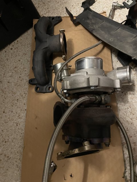

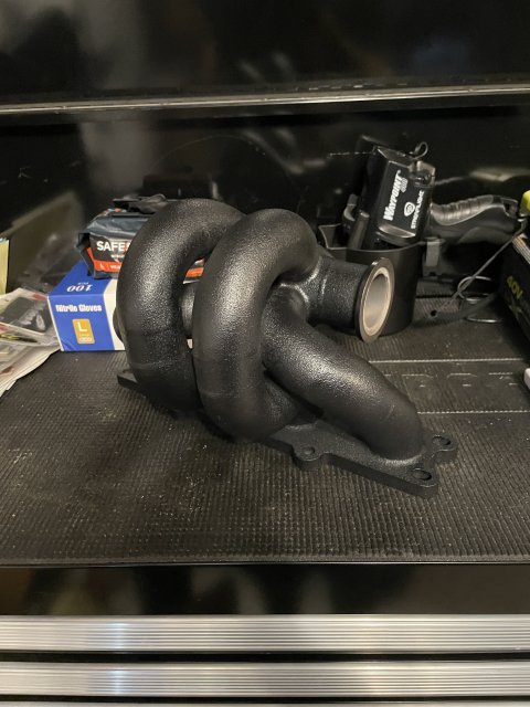

Some manifold porn. Had to pull the HPFP to get it in which was annoying, but oh well. Hanging the turbo tomorrow then on to injectors and plumbing the charge pipes and fuel line.
View attachment 59914 View attachment 59915
That is definitely nice looking. What performance advantages does it bring?
