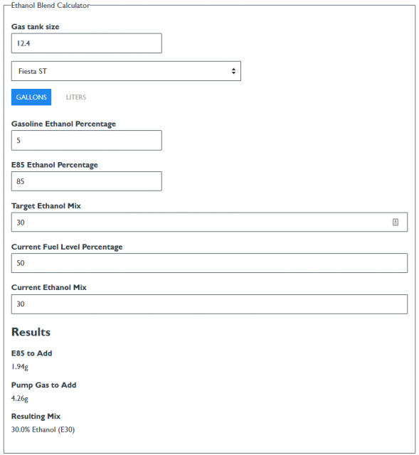

Oh well that's a nifty calculator.
If I understand this right, assuming my station has the same fuel quality as yours (I will test mine), this is my result below:
So with ~2g E85 and ~4g 93oct I can refill at half a tank in this scenario. Depending on my testing, I'll just have to adjust numbers in the calculator.
Seems pretty straightforward to me. Thanks for the assist!

Yeah just test the fuel, view the fuel percentage gauge on the Cobb AP, input the numbers and you’re done. It’s completely accurate according to my Dizzy Ethanol Gauge.
For the fuel jugs, just put 6 for the tank size and fill accordingly.
