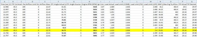

Use the AccessPort montors to help you determine the limiter.
Monitor: Load Actual vs. Load Desired
Monitor: TIP Actual vs. (C) TIP Ceiling
Are either of these being exceeded?
Thanks... No there's plenty of margin there that I can find... datalogged a lot of that yesterday:
@5813 RPM where ETC rolls back -- TIP Actual 20.18 PSIG, TIP Desired 29.98 PSIG TIP Ceiling 45.5 PSIA
Load Actual 1.819 Load Limit COMB 2.836 Load Limit FSC 3 Load Limit LSPI 2.4
I'll keep digging.

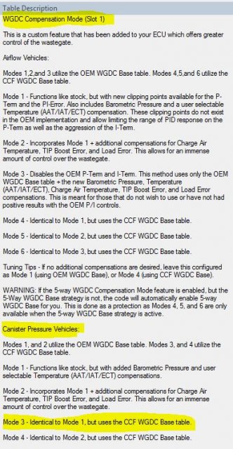

I'm reviewing your map data. One thing that popped out is that you have the Switchable Maps WGDC Comp Mode set to "3". That means you're still using the OEM Base WGDC, not the CCF Base WGDC. When I'm done, I'll send you my recommended changes version of it saved as a different name. Then you can do a Compare on yours and my tweaked version of it and decide for yourself. You will likely need to make some adjustments in the CCF WGDC to follow your desires.

If you scroll down on the description for Mode 3, at first it mentions other cars, and then below the Cannister Pressure ECU's and mode 3 uses CCF WGDC. I tried mode 4 and there was a difference in ETC source (6 for Mode 4 and 5 for mode 3 so I went with mode 3) but identical ETC behavior. See attached.
4th gear pulls

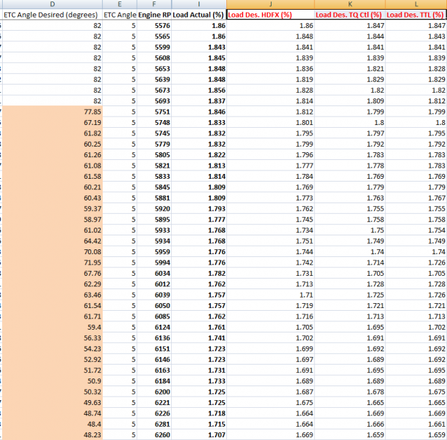

Ok, rather than make your map look like mine, let's get right to the problem.
Please add this PID to your data log: Load Des. TQ Ctl (%). The result of your TTL, LTT, and TRT are summed up in this PID which is the final result for the requested Load. You can also log the Requested Torque just for giggles.
I'm thinking that when you log this, it will show that your actual Load vs Load Desired is the actual limiter you're seeing. When that is confirmed, you can adjust your TTL, LTT, and TRT up at and beyond 5750 rpm. In fact, that is exactly when your ETC closes up (@ 5750+)…
The % of ETC indicated is closely related to the amount of "over Load" sensed.

If you look at your log closely, you will see that near the end you still have the PPS at 100% and when the Actual Load drops below 1.6 (your max value in TTL is 1.6 @+ 6500), the ETC starts opening back up. I'm sure the TTL, LTT, and TRT is the problem!

Happy to report that all is great, thanks to you all for steering me in the right direction. Needed to adjust quite a bit, and rebuilt the TTL LLT maps in Excel to match up also with a proper X/Y. I may do some VE mapping in the future just play around with it, few tweaks to get the right feel and minimize any traction loss in lower gears. Received the E content setup today (thank you Jason) so I will be able to dial in the right slot for the right %. I have it set up to load slot three now with a map update for E30 and will go up or down depending on the %. Super happy, with this and the support this week from MeisterR on the GT-1, I’m in a very good place, thanks again for all the help!
