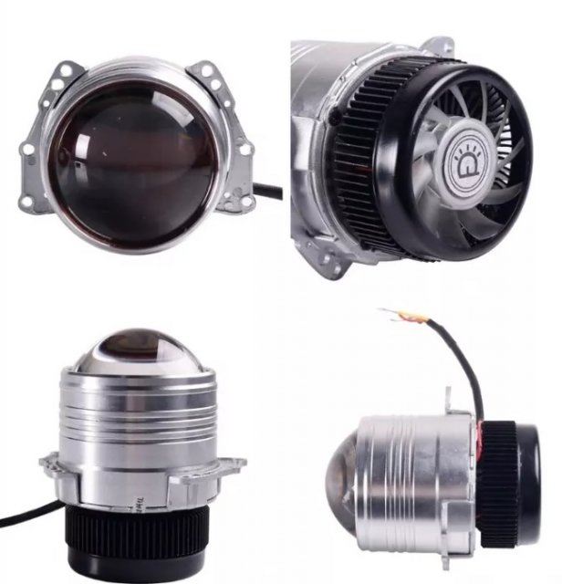

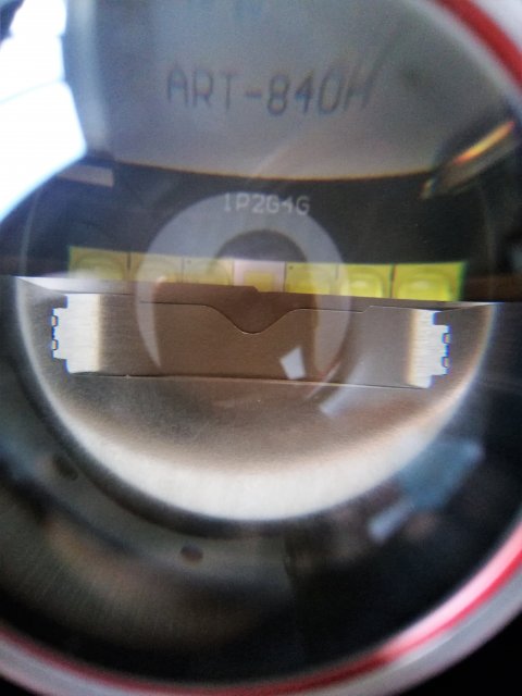

I bought a bi-led lens matrix type in China.
https://russian.alibaba.com/product...led-projector-lens-headlight-60769843509.html

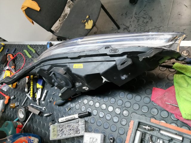

Installation of lenses is very simple. The lens mount is the same as the OEM lens mount..
All elements are in the middle of the headlights.
There is nothing outside.

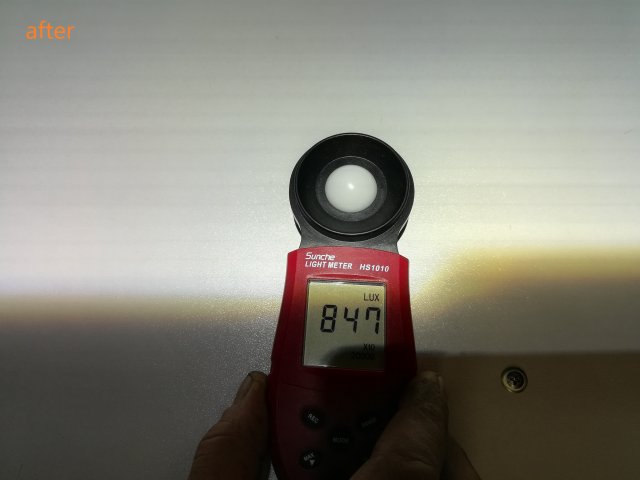

Before halogen and after bi led

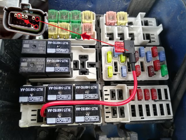

Circuit for connecting high and low beams of DRL

Interested to see how this mounts inside the housing. I assume this is an all-in-one LED projector with integrated bulb, and you still had to take the headlights apart for install?
M
7
9
Ukraine, Kyiv Oblast, Ukraine
Yes, this is an all-in-one LED projector. The headlight is completely disassembled and new lenses are installed.

Here you go. I was not able to get any sort of measurements as I'd have to have fully opened up the light to do so, but this is what it looks like. Basically, the low beam projector is attached to the rest of the housing with four screws, and then routed into the leveling motors/screws somehow. It is absolutely conceivable to me that you could swap in correct projectors as indicated in the original post since the projector itself is a discrete unit.
Happy to take more if needed, these may not be as clear as intended.
