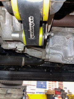

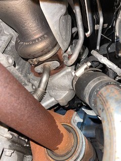

I purchased a 2016 ST this past Saturday. I have 0 experience with them besides what I've read in the last day or two. It's been raining here since Saturday so haven't really put the car through it's paces, but noticed it felt fairly strong for only having 197bhp, and sounded a little louder than I expected. Today I put the car on the lift to take a look at it properly. It has a 3in exhaust which looks like a Thermal unit. It also has a Whoosh rear engine mount. There is also an upgraded intercooler which I'm guessing may be from Whoosh as well. It's thicker than stock and has metal end tanks. The intercooler appears to be the same height as stock just thicker. Nothing has any wording or logos on the parts besides the rear engine mount. I believe the turbo is stock, but how could I tell otherwise? Also how can I find out if it's tuned and what tune? I'm hoping it's a 93oct tune and that someone didn't trade it in with an E30 tune or something. Thanks for any insight or help. I'll post pics of the turbo I took.

If it’s a whoosh intercooler it’ll have their logo on the end tanks. Turbo is definitely stock or a whoosh hybrid, but seeing as the heat shield is still there I’d be willing to bet it’s the stock unit since most people don’t put them back on after swapping turbos.
Tune is basically impossible to tell. Did you get an accesssport with it?
