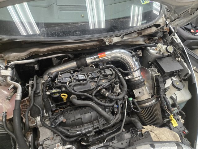

Since im snowed in, im taking the time to build a 3.5 inch cold air intake for this. Mostly because I want the noise and looks. And the battery box is gone. And....
I paid 5 bucks for this k&n setup off a 90s mod motor Ford truck that was headed to the crusher. It's a good starting point with the large filter and nice bellmouth.

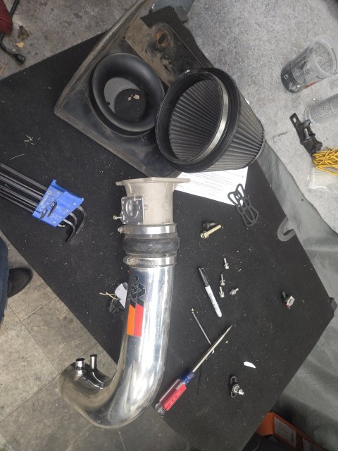

Lastly for this update, I wanted a different intake. Partly because im a 90s kid, and partly because the factory one had nowhere to mount anymore. As the GRM challenge makes for strange happenings, I made things work.
First up, the parts: I buy all the cold air intakes and cone filters my scrap guy gets. He charges me $5 a pop for them. I figure they’ll come in handy for something someday, and over the years they have turned into intercooler piping, a Datsun 280z cold air setup, supercharger intake piping, you get the idea. I have also collected random free leftpvers from intercooler piping kits and such, for the same reaspoins. Id assume most reading have the same kind of stash of parts. Im just more organized, with amore understanding wife and more space for hoarding.
Anyway, I started with a mod motor ford (90s I think) k&n setup from a truck. Even had the MAF on it still! This is 3.5 inch diameter. I also had a random aluminum tube that looks honda-ish, and is 3 inch. Add in a blue reducer valued at 2 bucks (junkyard price) from 3 inch to 2.5 for the turbo intake elbow, and some hose clamps from my bucket of used hose clamps, and we have the start of something hideous. I apparently didn’t take before pictures in as purchased condition of either intake. Sorry.
20260131_144831 by Michael Crawford, on Flickr
20260201_092122 by Michael Crawford, on Flickr
20260201_094335 by Michael Crawford, on Flickr
Cutting the “honda” tube down to make it a 45ish and ending straight got us to the above picture. Close. You can see the maf housing has a nice bellmouth that bolts to it for that giant filter, and I wanted to retain all that. However, it’s full of cast in crap, and my maf in the fiesta is a rectangle. So I had to MacGyver some shit up.
Started by cutting the majority of the crap out of the tube with a Sawzall, then chucked the housing in my 50s era atlas benchtop drill press to make the beginnings of the slot.
20260201_145903 by Michael Crawford, on Flickr
After that, I dremeled the protrusions in the bore of the maf housing the best I could for airflow and structure, and made the drill press series of holes a rectangle via a series of files and a lot of effort.
20260201_160635(0) by Michael Crawford, on Flickr
What bit me at that point was the rpund hole for the original maf sensor. It was slightly outside the o-ring seal for the fiesta maf. Couple ideas presented themselves, but the most bulletproof solution I could think of was making a more solid flat plat with a better hole and attaching it to the top of the 90s ford maf housing. So, I used a scrap of the cut-up aluminum form the floor of the cup car that I made my ECU mount out of, and made another rectangle hole in a chunk roughly shaped like the flange of the factory 90s ford MAF.
20260201_160642 by Michael Crawford, on Flickr
I then drilled and tapped two 10-32 holes in the patter of the fiesta maf through both the plate and the 90s housing. Slightly crowned the plate, slathered a LIBERAL amount of RTV around, bolted the fiesta maf in to clamp the plate down, and then since I’m a belt and suspenders kind of guy I clamped it some more.
20260201_163224 by Michael Crawford, on Flickr
20260201_163228 by Michael Crawford, on Flickr
Once that all cured, I went and got my hose box out (all those leftover scraps of hoses at the end of a project? I keep them. Same with the random hoses in silicone hose kits that don’t fit whatever the hell they’re supposed to, the good hoses from part outs, etc. they go in the box. This box used to be three boxes, I recently purged). Out of the hose box I used some scraps to tie in the evap line and the valve cover breather that had gone to the factory intake tube. It took a bit of fuckery, but we got there.
20260202_170032 by Michael Crawford, on Flickr
20260202_172254 by Michael Crawford, on Flickr
All buttoned up. I think I’m going to take a chunk of aluminum and tie one of the bellmouth bolts to the motor mount bolts to give it a secure bracket. Id love to come up with some heat shielding too, but that’s a future me problem.
20260202_172240 by Michael Crawford, on Flickr
The most important thing: it makes intake and blow off noises now. That makes the 90s kid in me happy.

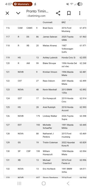

So, long time no real update. Mostly because of life on life’s terms.
The scheduled autocross test and tune was weathered out. So instead, we teamed up with a friend of mine to co drive the car in XB for the season opener with CCRSCCA. 10 runs back-to-back, taking first and second in XB. The car, despite the changes, still didn’t want to rotate. However, it was way less pushy! We kept adjusting tire pressure trying to make it better, and nothing seemed to help. We were only putting the car in sport mode.
20260307_093915 by Michael Crawford, on Flickr
20260307_093928 by Michael Crawford, on Flickr
Screenshot_20260307_160655_Chrome by Michael Crawford, on Flickr
