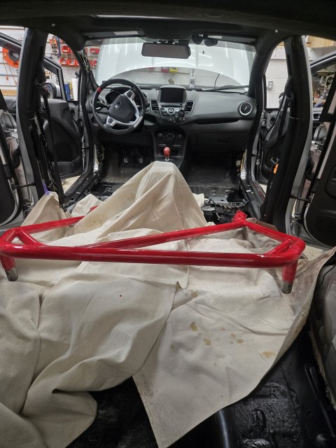

Since it is getting cold, I put the white wheels on it(not in current challenge budget) after putting some all seasons on them.
20251027_140008 by Michael Crawford, on Flickr
recent service was axles, fluids, alignment, brakes. No record of valve cleaning, timing belt, plugs, or coils. I know it needs AC repair, as well as a blend door so it can have defrost. Rear windows don’t work. Rust needs addressed before it becomes something more. Battery cables need tidied up. Cosmetic attention. Autocross. 2026 grassroots motorsports $2000 challenge as a half budget competitor.

Previous budget:
Car and speed parts: 800
This update: focus svt partout
Bought 03 focus svt roller 400
Sold bumper, ecu, gauges for 380
Sold interior 250
Sold shell minus wheels 250
2003 svt total: svt wheels and -430 dollars in recoup
New total: 370
Let’s start the update today with parts. Because what’s better than cars? Parts.
Included with the purchase of the car was a pile of parts. The stock seats (100), the white wheels, and this pile in a box:
Screenshot_20251120_091055_Gallery by Michael Crawford, on Flickr
What I didn’t realize at the time, and didn’t realize until I really looked into the box earlier this week, is what it contains. In the box there’s an entire powerflex handling package worth of bushings in there. Motor mount, LCA bushings, rack bushings, beam bushings, and something else. Theres also some as yet to be identified whoosh aluminum bits that we think are for the shifter, cobb case, factory glovebox manual, spare lug nuts, rally armor mud flaps, stock brake pads, stock brake backing plates, h&r wheel spacers, another race seat munt, factory fog lights, and some other stuff I’m forgetting.
Screenshot_20251120_091105_Gallery by Michael Crawford, on Flickr
A very good box.
