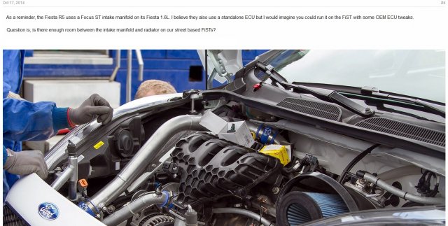

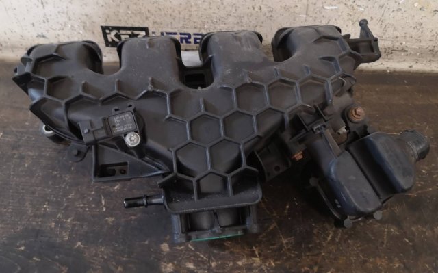

has anyone successfully tried this? is there enough space? my biggest concern is the clearance with the alternator

The 1.6EB and 2.0/2.3EB are completely different engines.
I was thinking something like an adapter plate / gasket in between
am more concerned due to the lack of space

Reason I am asking is because they LOOK about the same size as the focus one (width that is)
sorry for so many generalities but can’t find the dimensions of either one 🙄

The MS3/6 and the pre-2016 (I think) FoST engines are both Mazda L-series engines, so there are some parts interchangeability. The 1.6EB, aka Sigma, is a completely different engine designed by Ford with a different port size and bore spacing.
The 1.6 tivct engine (fiesta ses) is also called sigma but I don’t think there any similarities between the two
actually it’s head looks more like the focus one than the eb fiesta 🤔
